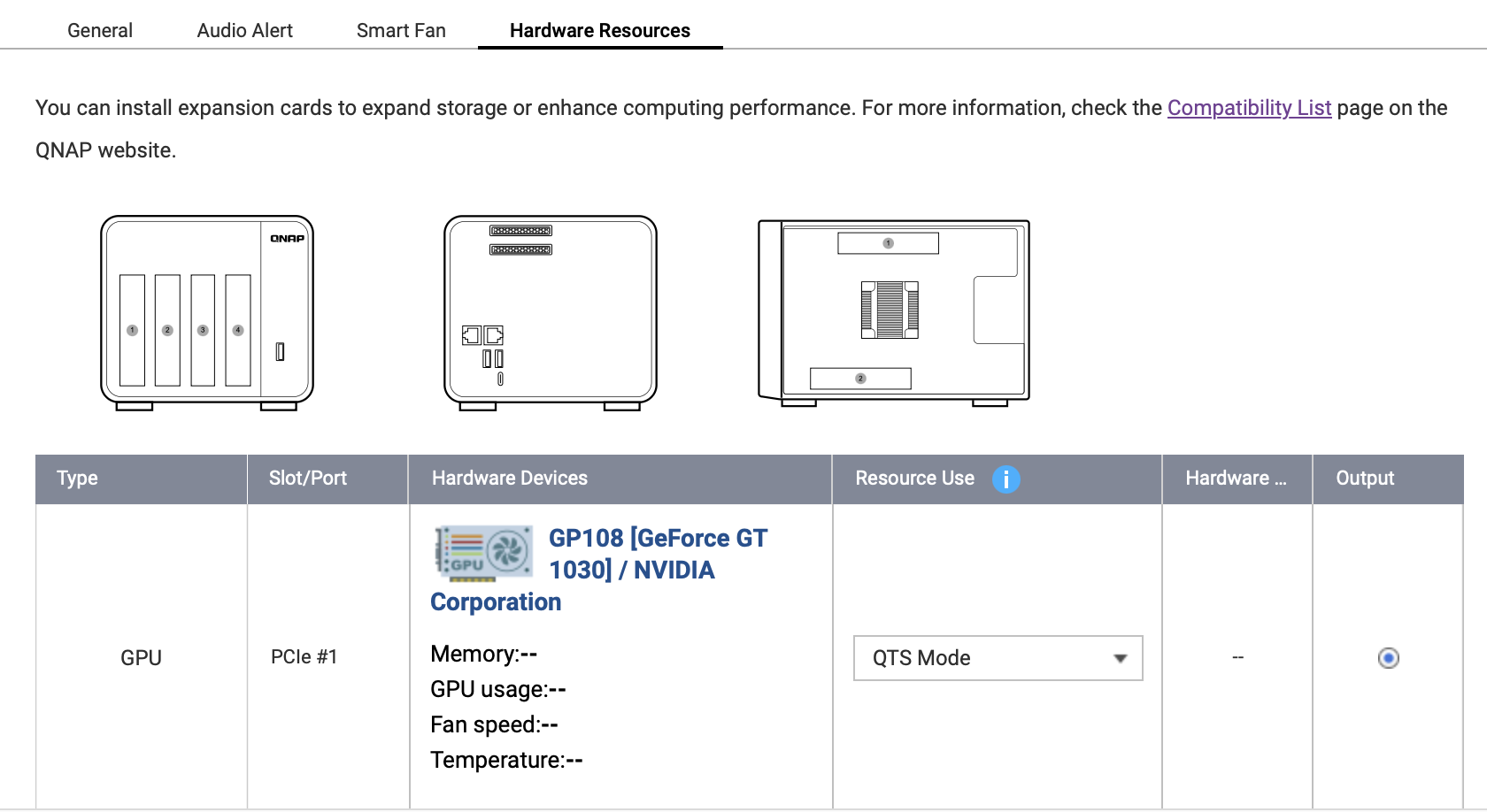

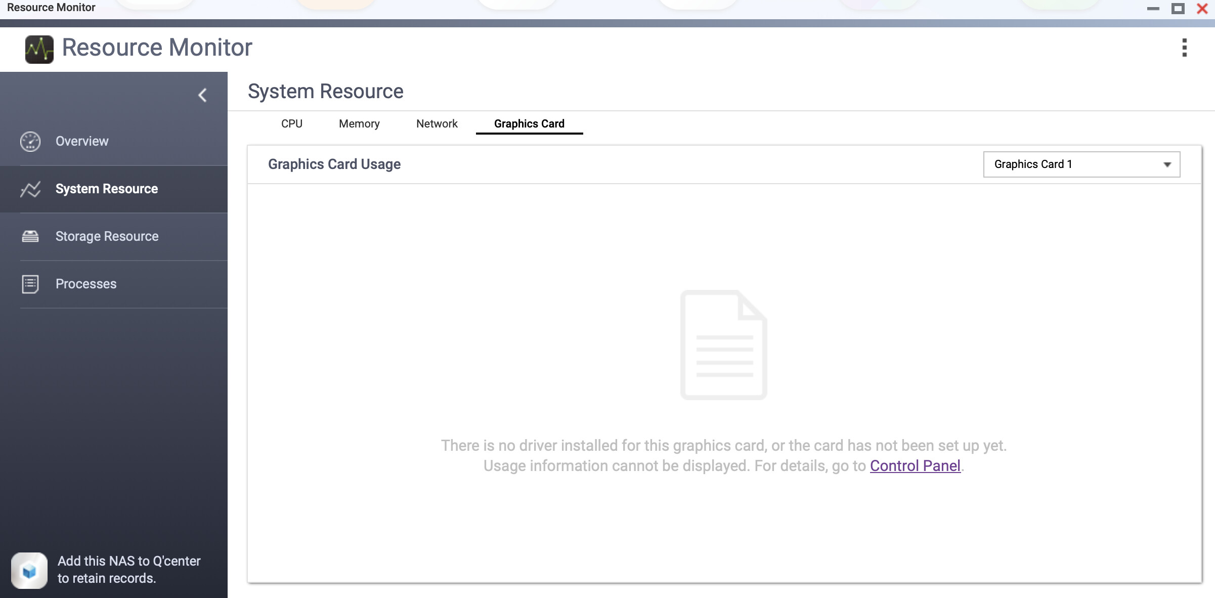

a TS-473a with 4 HD and a GeForce GT 1030. With the latest firmware update it seems like braking the GPU pkg: Error 2025-05-19 15:08:26 --- --- localhost --- Hardware Status --- [Hardware Status] Failed to automatically install the driver: NvKernelDriver. The GPU is not functioning. Check the internet connection and manually install the driver through App Center or download it from the QNAP website.
The second issue is that in the hardware control panel it does not show any metrics:
It’s very frustrating when spending money on a NAS and using official supported hardware and having those kind of problems.
UPDATE: Removed the NVDIA GPU Driver, reboot, reinstalled the driver, reboot. Still nothing.
