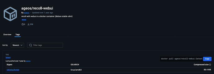

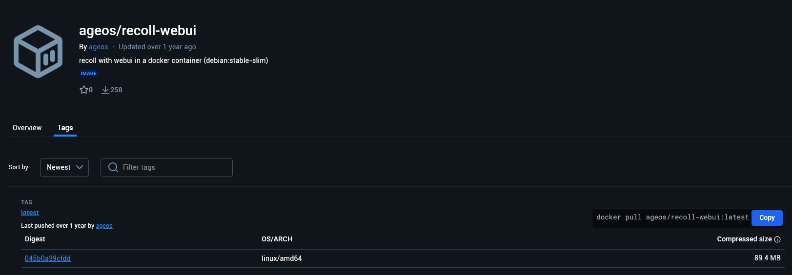

Did you check that the docker version you pull (there is a couple google spits out) is compatible with limited ARM?
This for instance is not

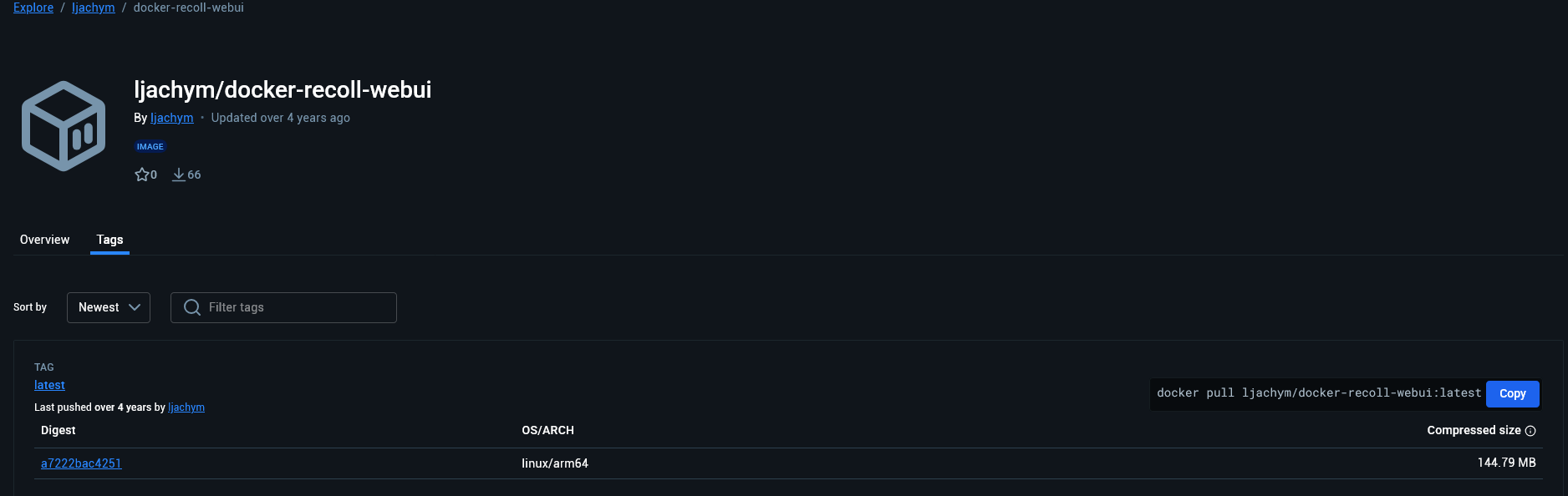

  • image: ljachym/docker-recoll-webui
  • error message when running recollindex: /usr/bin/env: ‘python2’:
    No such file or directory
    Indexing failed

Doesn’t seems to be arm compatibility issue: I have access the Recoll web search interface
arm64 for that model.
armhf was only for 32b CPUs anyway. I don’t think QNAP are making NAS with 32b CPUs anymore. :nerd_face:
