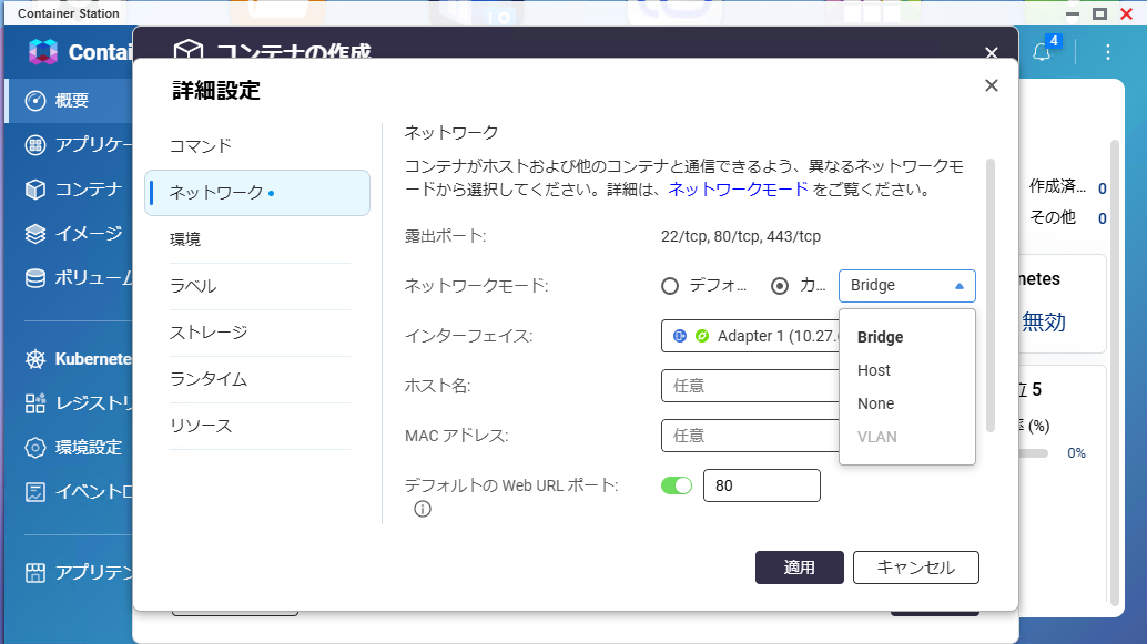

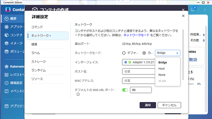

It seems that the URL you sent does not have detailed information, but I think it’s better to configure the git container with a bridge setting rather than NAT, so that it shares the same IP address as the external network.
With NAT settings, you would need to set up port forwarding, and specify ports other than 80 and 443 for http and https, which would make configuring the git client more troublesome.

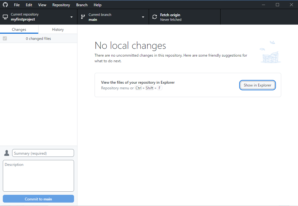

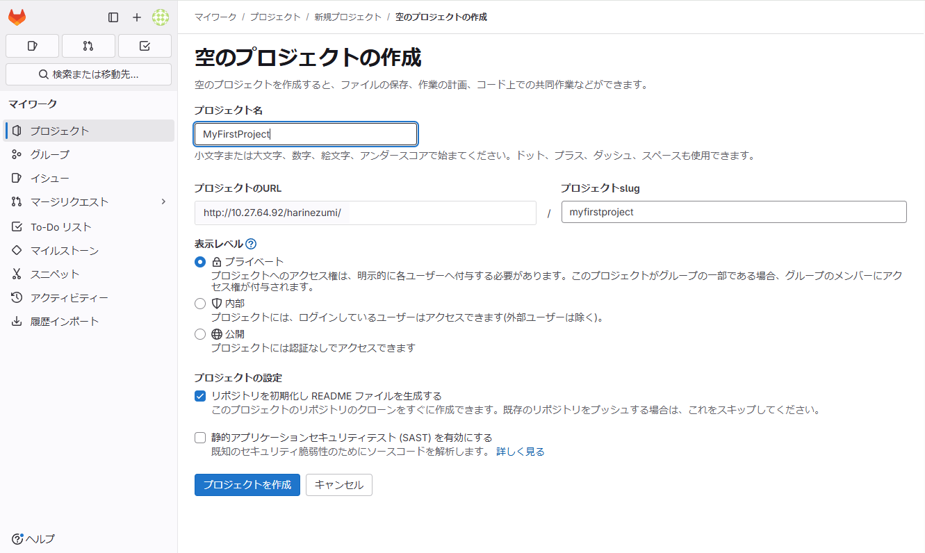

On the GitLab container, create a user and then create an empty project.
In my environment, I was able to clone from the Windows git client to http://10.27.64.92/harinezumi/myfirstproject.
If you’re operating locally, ssh access isn’t strictly necessary.
Why not start by checking the simple things?
I think if you expose the Docker container via bridge, it should work without any issues.
@Harinezumi
Thank you very much for your reply.
I was able to successfully clone via http using the method you described. Thank you very much.
