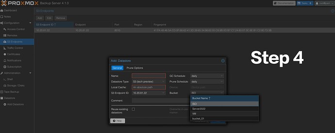

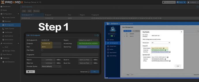

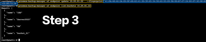

I tried it, but it seemed to fail at first. I found that there was a problem with the SSL certificates when PBS connected to QuObject. You can try the following steps and let me know if it works.
