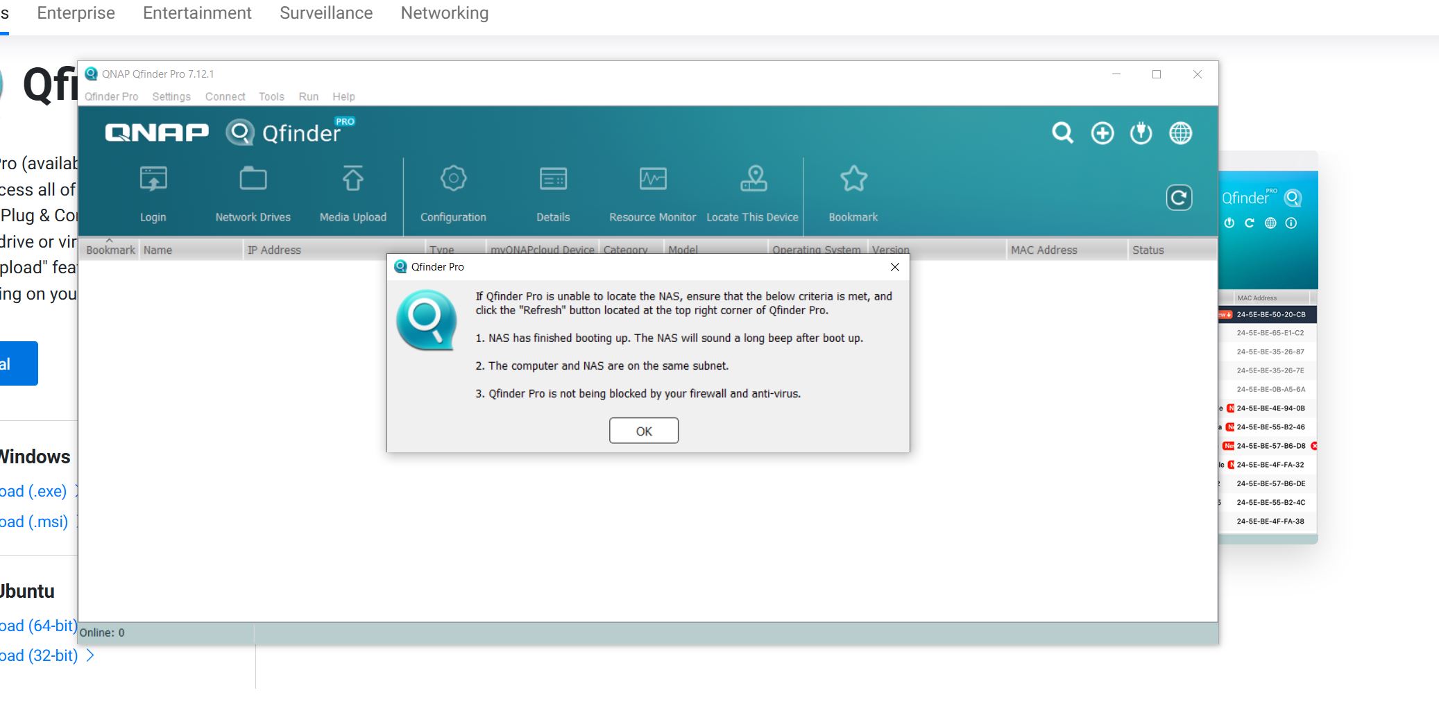

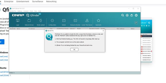

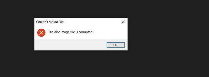

So we just bought the TS-433, when we plug it to the Switch, it color turn from orange to green.
Then we use our computer under the direct LAN Network, same network & ISP, but different floor.

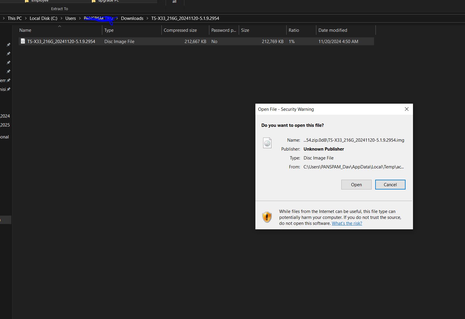

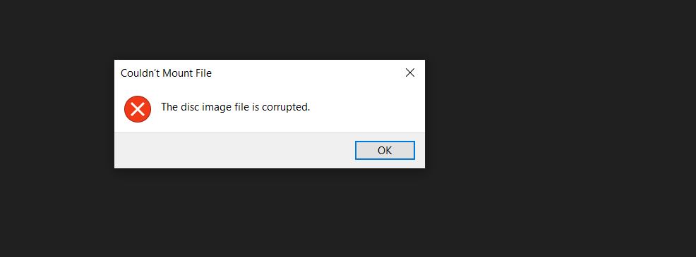

It failed to detect to recognize the NAS, and also when we try to install the QTS, the file seems unable to open the file (unrecognize)

When you can’t find your NAS, you have a network problem.
Find your router the NAS ?
Which IP has your NAS become from the router ?
Can you log in with your browser “192.xx.xx.xx:8080”

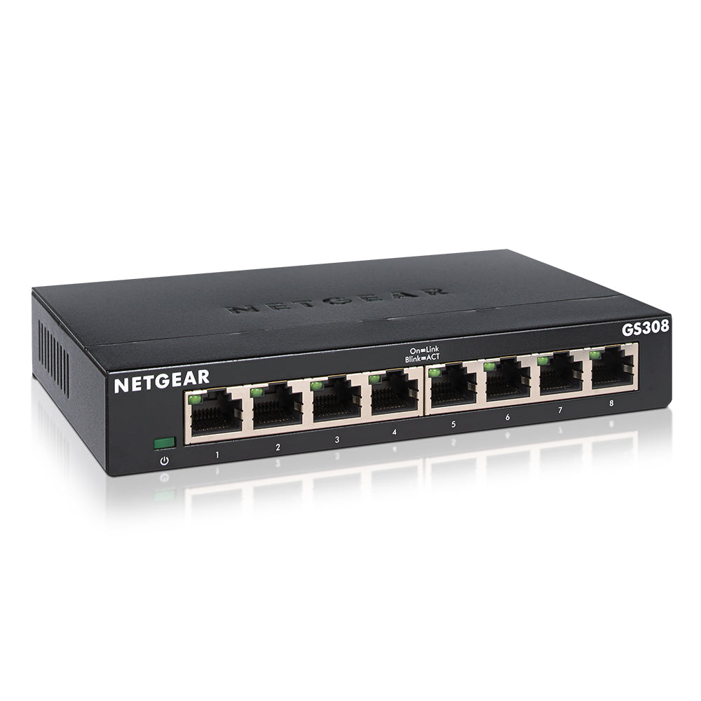

I see, I will try to use Switch in my next attempt so that the network is closer and have the same network
After I bought & Install it, it still can’t detect the NAS system
Your NAS received the IP from the router in your network.
I have a fritzbox as router. This router is the DHCP-server for my network. This server give my NAS the IP.
Your switch is no DHCP-server.
