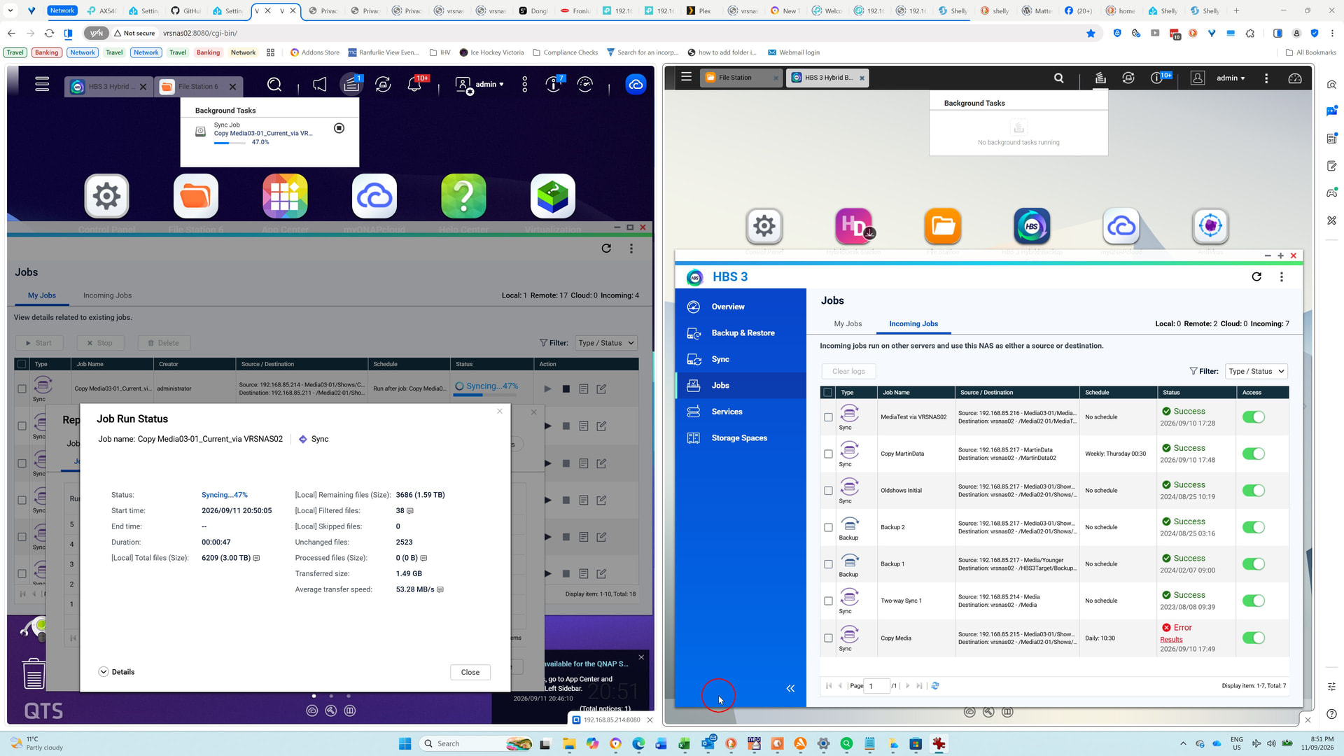

as far as I can see, one of the new jobs works, and shows up in the target NAS (VRSNAS02) as a background task and is also listed in the target HBS3 incoming jobs list - MediaTest via VRSNAS02. this is listed in the target NAS HBS3 incoming jobs list as entry #1
the second new jobs in my example is Copy Media03-01_Current_via VRSNAS02. This job copies files, however the is no recognition in the target NAS interfaces. no background task, and nothing listed in the HBS3 incoming jobs list.

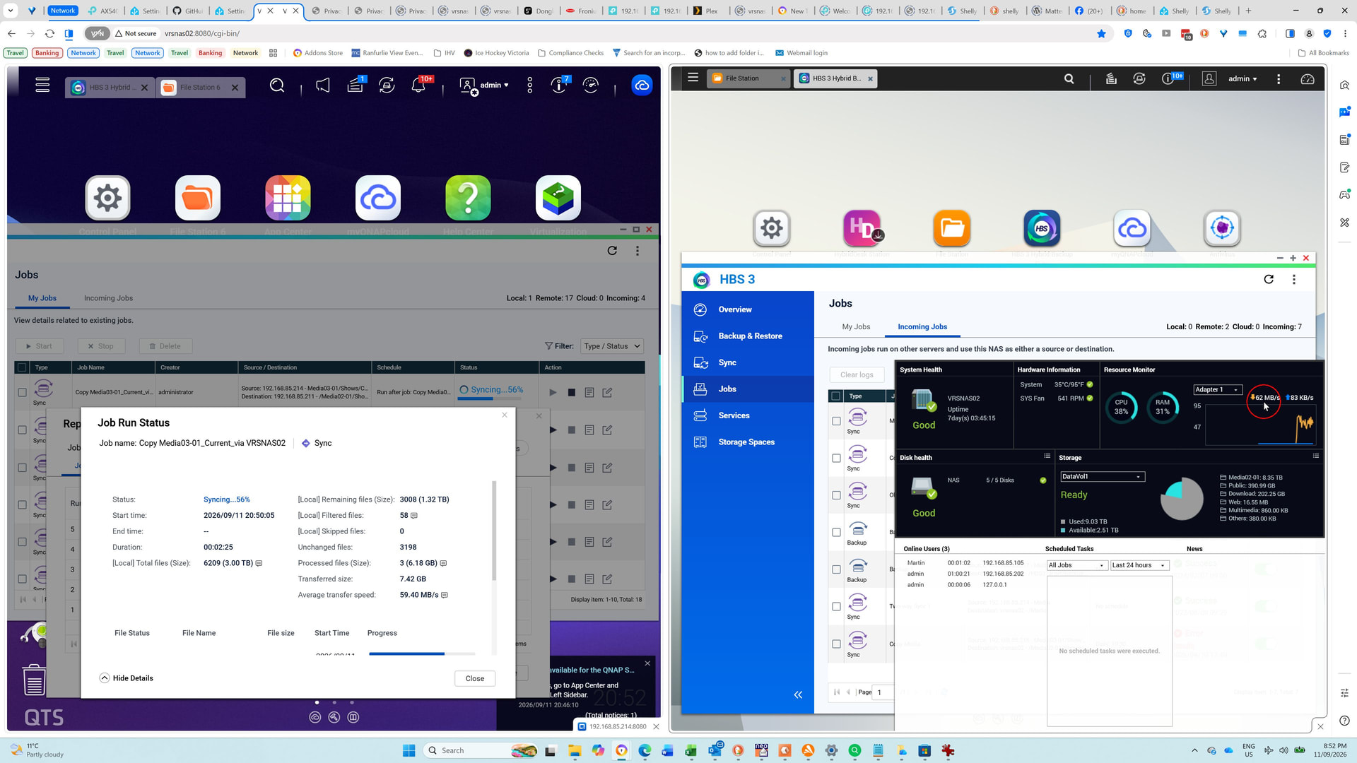

Screen shots show
1 - side by side NAS consoles with second job running
2 - same displays with target nas dashboard in foreground. note the incoming 62 MB/s rate as a result of the active copy job

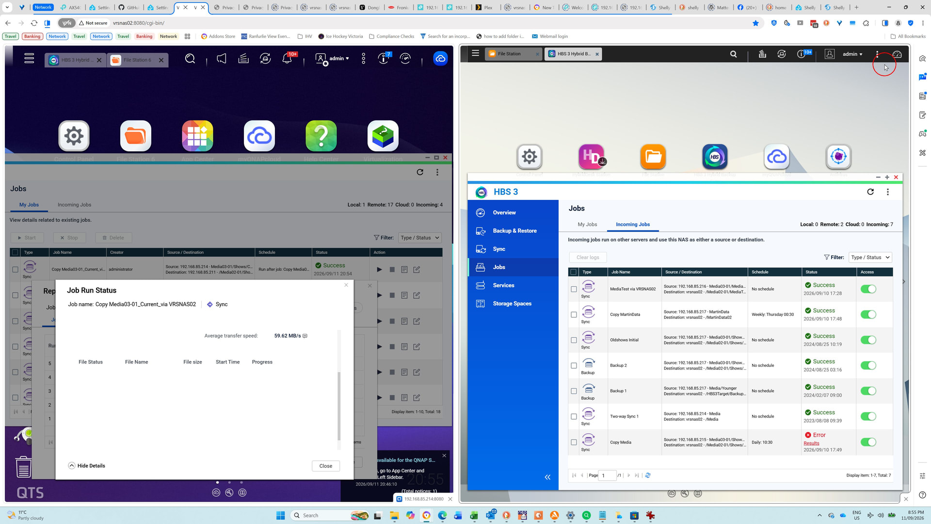

3 - Job has completed - success listed in source NAS HBS3 Jobs list, No records in the target NAS.

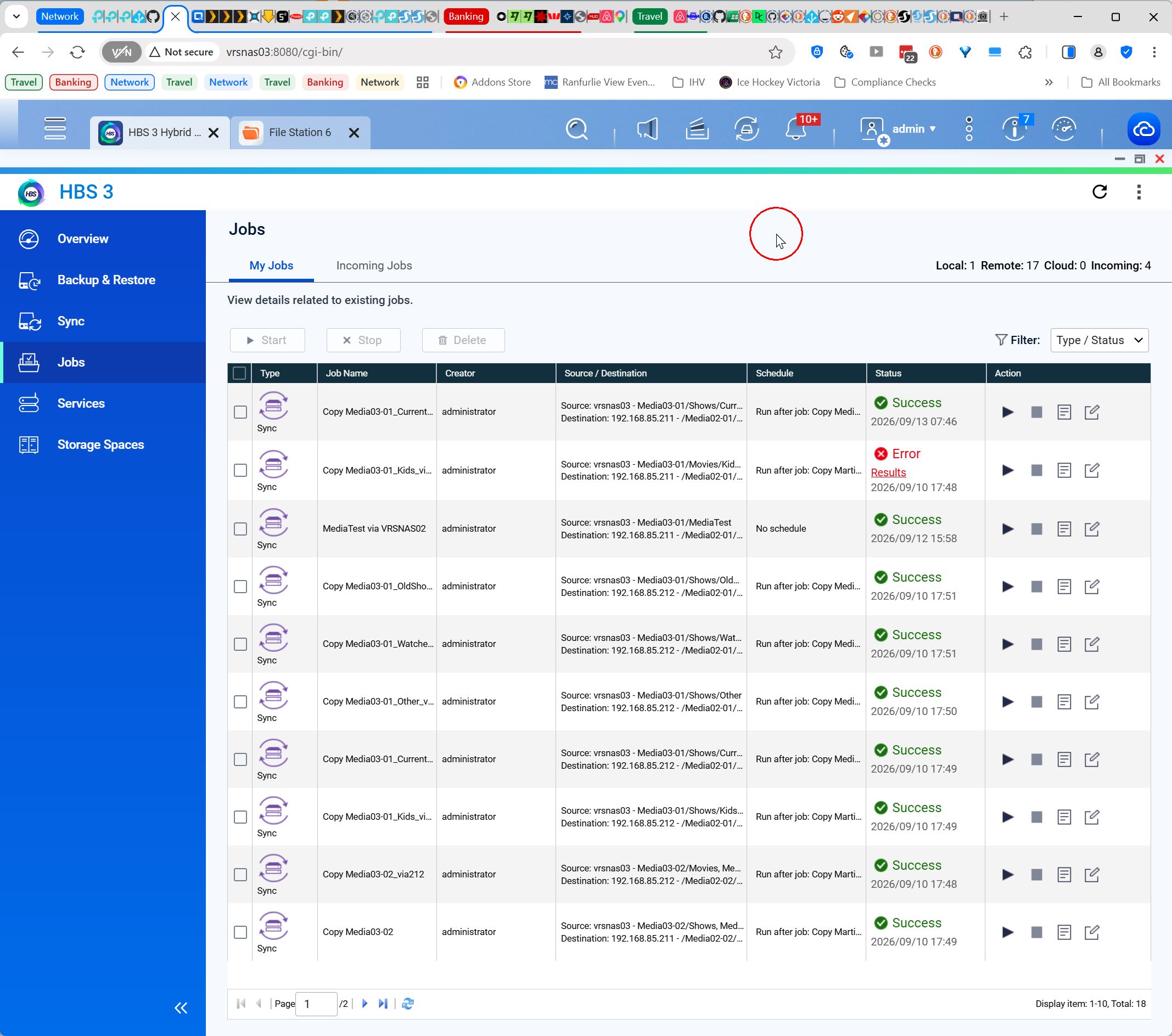

To display the settings in the two jobs, I have used edit, then sequentially taken screen shots.

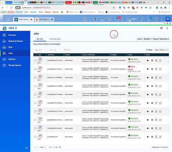

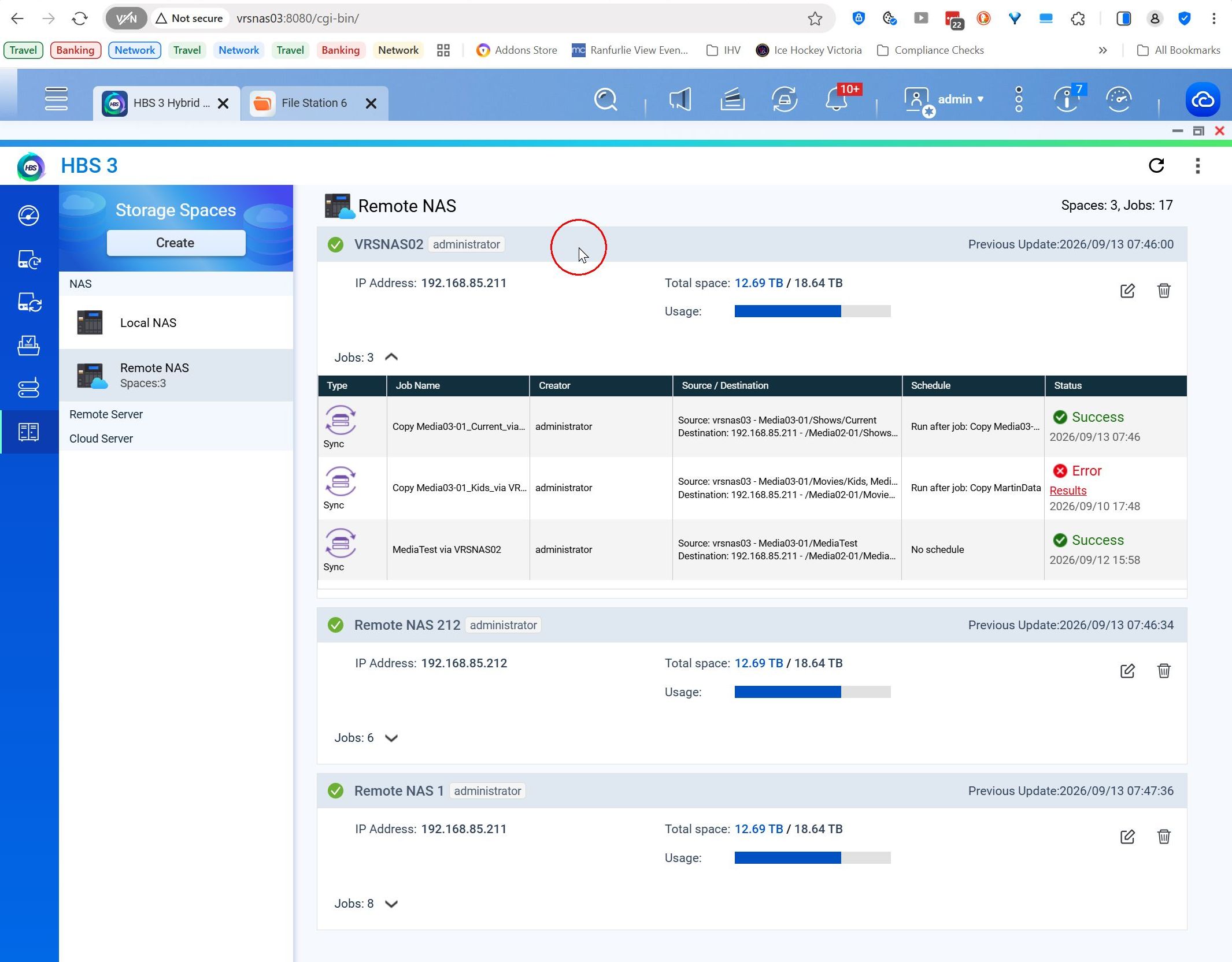

These are all taken from the source QNAP (VRSNAS03) and show a) jobs list b) Storage spaces with the target definition highlighted. The successful job (MediaTest via VRSNAS02) is the third entry, and the ignored job (Copy Media03-01_Current_via VRSNAS02) is the first.
Whenever I run the successful job, it shows on both the source and target NAS job lists.
When I run the ignored job, it only shows on the source NAS, despite data being transferred to the target.
Whilst taking these screenshots I noted two differences
a) no schedule vs Scheduled after job xxx
b) network interface - Automatic vs Default Route
by amending the Network interface to Automatic, the job runs and is recognized and reported by the target QNAP (VRSNAS03).
Is this expected behavior for the various network interface options?
PS I have screen shots from both job definitions plus the debug logs, if required

So did setting up new jobs then resolve your issue?
John,
All old jobs have been deleted with new jobs created. in early testing, the new jobs also failed.
The issue has been addressed by by amending the Network interface from Default route to Automatic.
Now, each job runs and is recognized and reported by the target QNAP (VRSNAS02) which delays the power sleep schedule while a job is running.
