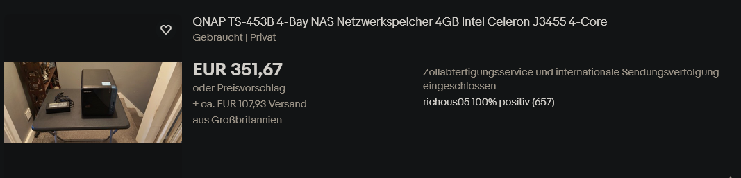

What kind of budget are we talking about? There are also used models without LPC issues.
For example, TS-453B (just checked randomly on eBay)
