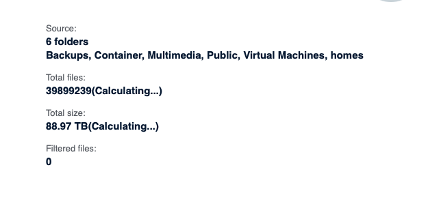

So I started an HBS job on the main folders to backup. It is six folders but HBS is calculating an absurdly large number of like 88.97
TB!

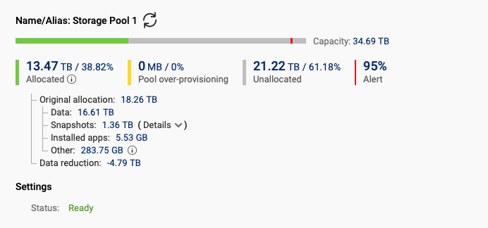

But if you look at the actual storage you see:

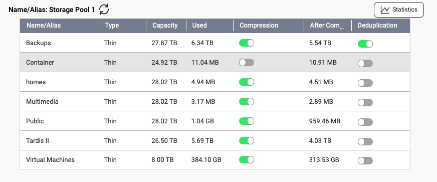

If I add up what is being shown as the size of the volumes I am backing up the size should be:
5.54TB + 4.51MB+2.89MB+959.46MB+313.53GB = 5.71TB
Not anywhere close to 88.97TB!
What is going on here?
Could you try temporarily excluding the “homes” folder to see if it still calculates such a large capacity?
Also, to help us further clarify the issue, could you please provide:
  • A screenshot of the detailed settings for your HBS backup job.
  • Confirmation on whether you are using the RTRR service or multi-versioning backup.
  • Specific configuration details for your source folder.
Thanks!
