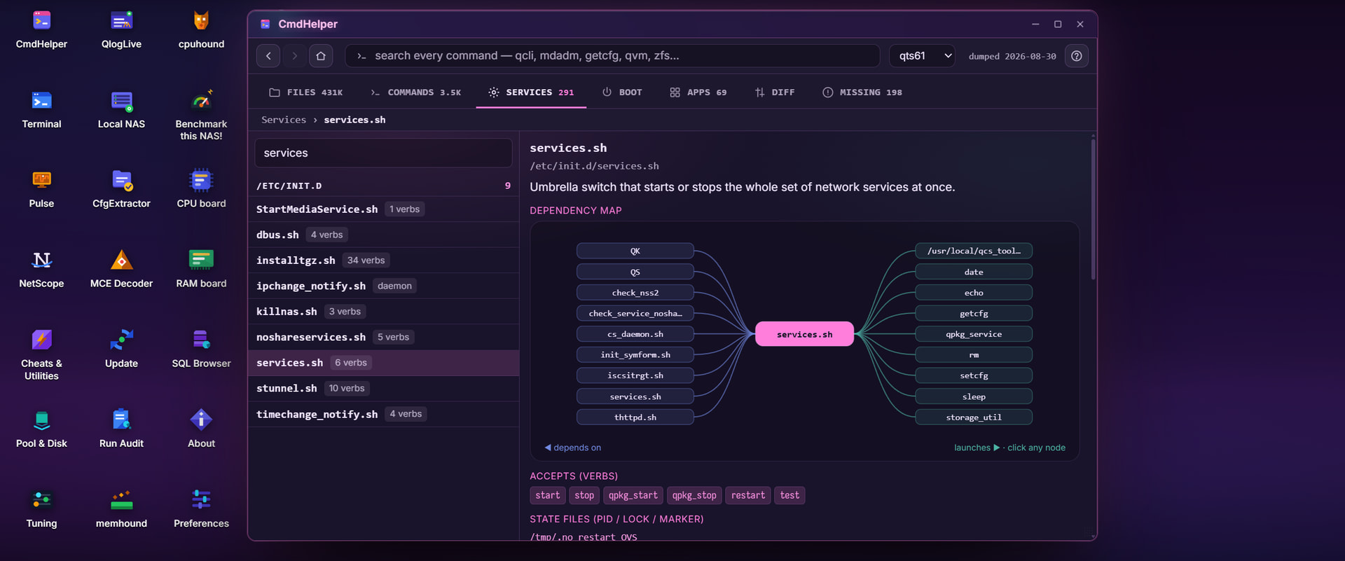

If you need to understand whole QNAP QPKG just install StorageDiag Workbench & Utiltities and from CmdHelper please look closer on a workflow how start/stop scripts works:
Ask me what you need and i’ll try to explain this to you.

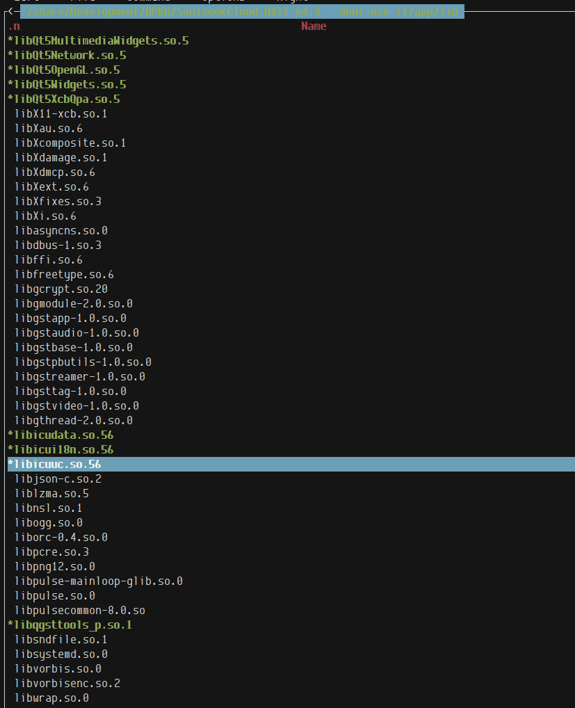

While we’re on the topic (as a partner developer), I assume this means QPKGs I submit have to be approved/rejected by someone at QNAP. My QPKGs often contain hacky workarounds to solve problems I’ve encountered over the years in different versions of QTS. Is someone at QNAP going to object to these?
In the old days of QTS 4.x and 5.x I simply shipped the whole glibc (taken from a Debian VM) with the application I was going to distribute and it was the same glibc where I compiled the application against.
This is how, for example, I did for TVHeadend QPKG. Probably it wasn’t the most efficient way “space-wise” but it worked :grinning_face:
I like it! :grin:
How do you get the application to use your specific glibc instead of the system one? That’s something I’m kinda hazy on.
i got your point,
i would recommend you recompile instead going that way, because in such case you has to supply ld-library together and do some workaround…hmmm

please look at start sequence
so i shipped my app together with own libc from other system
listen to me… this was for QTS <6.0
from now QTS is Ubuntu24 and you can compile anything you want and even just copy from Ubuntu24
if you wish me i can even writte some skills for claude/codex/copilot and others with instruction how to exactly compile and write compilation scripts if you want
the other way too do such things is native chroot and run app from chroot
but as i said - please avoid those two methods, are legacy from the moment when qts 6 goes out
