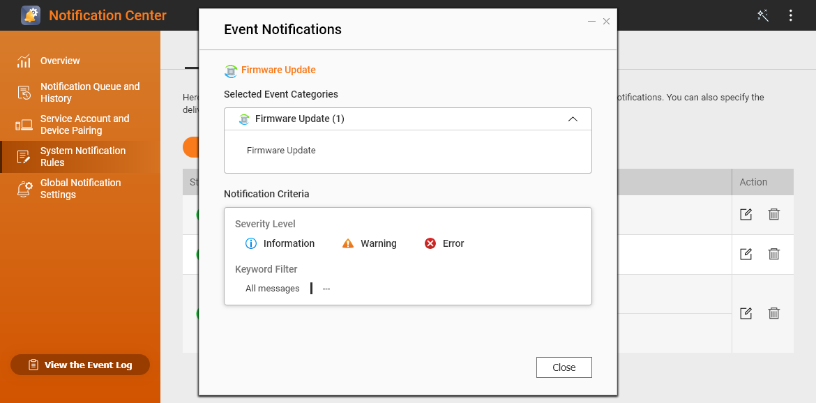

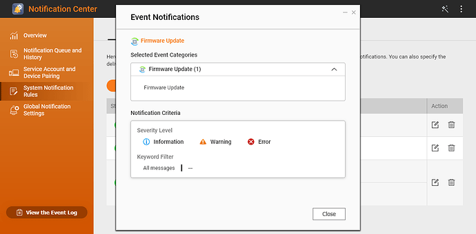

I'm not getting any firmware update notification although I set it up
I set it up to check daily for new firmware and notify me, not to install anything automatically.
When I log-in with an account (not admin, I disabled that account) that’s part of the administrator group I’m not getting a desktop notification of new firmware, although I checked that box.
I set up notification center to send firmware update notifications. all severity levels, and using two methods: push notification and email. I’m not getting ANY notifications of firmware updates.
Both methods work just fine: I am getting push notifications for app updates, I get the test notification mail.

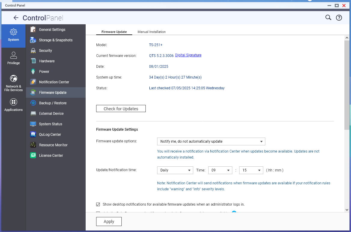

Today I had to manually check for updates again to be able to upgrade to the latest firmware version, which was released a couple of days ago ( QTS 5.2.5.3145 build 20250526), although I haven’t changed the settings you can see in the original post: It should check, daily for new firmware and notify my.
The firmware update screen said it last checked on May 25th.

I haven’t received any notification of the latest firmware update, QTS 5.2.7.3256 build 20250913 2025-09-25. It’s been almost two weeks.
In control panel, on the Firmware Update page, it says last checked 05/09/2025 20:53:18 Friday although I’ve set it up to check daily at 09:15 and notify me.
