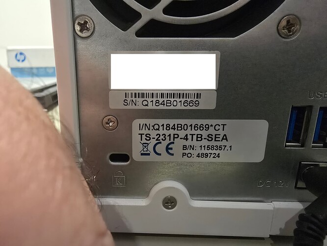

NOTE: Originally I thought this was a TS-220, as it was described in the store listing, but after checking the back, I found out what I got was TS-231P

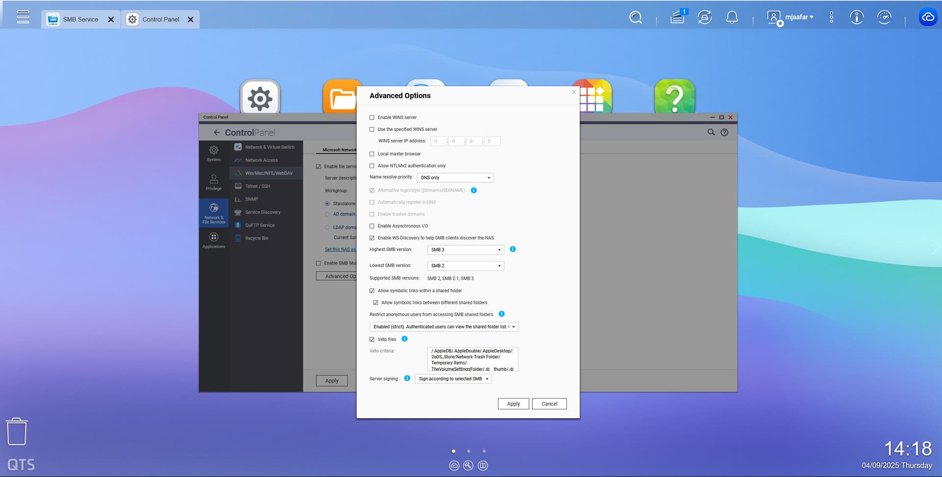

Thanks, from what I can find that’s already enabled by default in Windows 11 and according to the QNAP settings it set as the lowest SMB setting

How did you see the SMB Level on the NAS? These old NAS do not show the SMB level in GUI, just via SSH (Never said to touch anything in Windows btw)
I can access the QNAP OS through the web-browser
and I think I know why, I just checked the back of the NAS to see if there’s a date of manufacture, but discovered it’s not a TS-220, as I originally thought, which was what it said on the store listing, it’s actually a TS-231P and from what I can find, that came out about 9 years ago.
My initial info was for a TS-220 (before you changed it) and that info is correct for that NAS
On the revised TS-231p the info is different and you can in fact see the SMB level via GUI.
