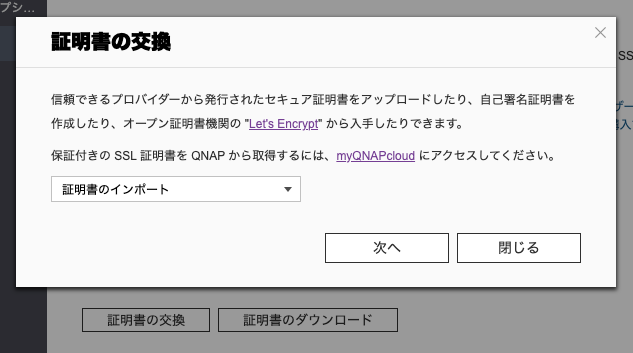

As another method, it is also possible to manually import the SSL certificate.
Paid SSL certificate for QNAP
Paid SSL certificates should also be able to be imported using the method above, but I’m not sure if it can be done automatically in 4.3…

First, I followed the method taught by HanzSung, where I purchased and installed the certificate from a different provider. This method uses a custom domain (completely different from myqnapcloud.com), so I bought the certificate from FUJI SSL and imported it. The only available authentication method was DNS authentication, so I tried that. With this method, there was no need to open any ports.
Another case was that the domain I had acquired from myqnapcloud.com happened to expire, so I tried renewing it as well. This certificate can be purchased from the QNAP management screen and is valid for 3 years and 2 months. It costs around $44, so it’s quite affordable. However, as expected, it was impossible unless ports 80 and 443 were open. Since I was using NAT connection, I thought there was no need to open ports, but that wasn’t the case.
