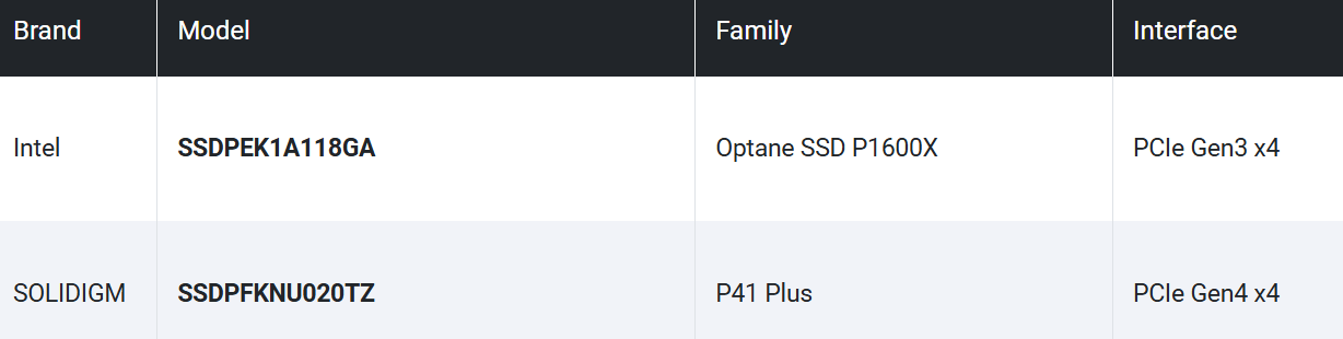

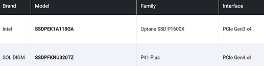

It’s not the MOST obvious from the compat list, they don’t have a column for M.2 type.
But if you had price checked anything on the list you could have noticed none are SATA.
Now that you know they must be NVME drives I bet the “Interface” column makes it really obvious to you.
See here
https://forum.qnap.com/viewtopic.php?t=124852
