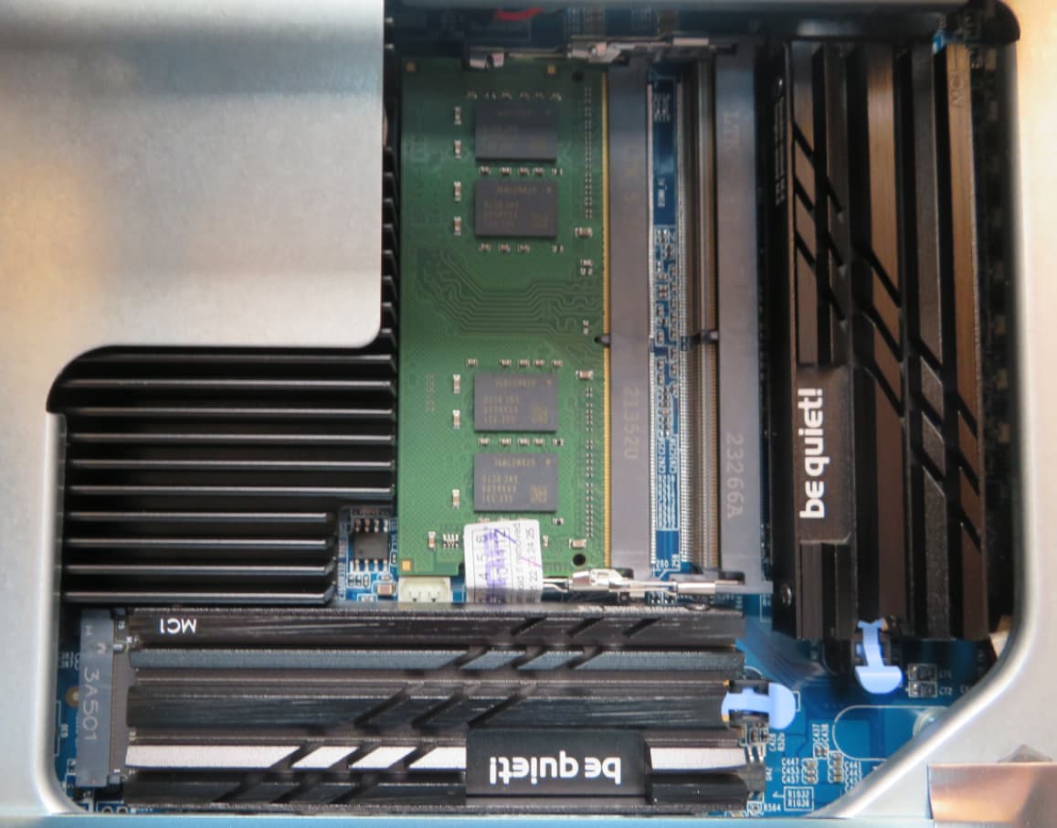

in my TS-264 i use 2 WD Red SN700 2TB with heatsinks (be quit! MC1).
