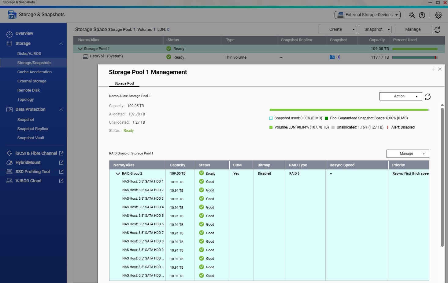

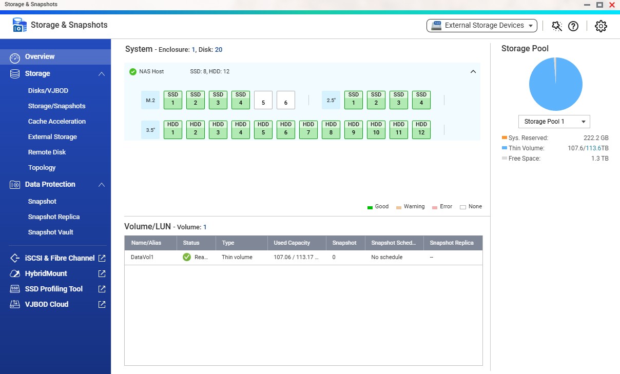

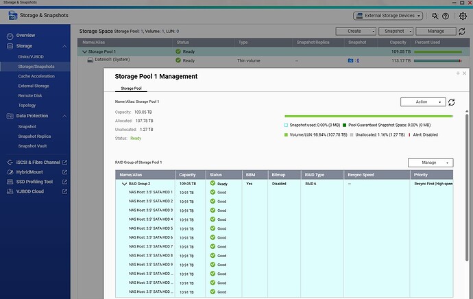

We will provide your requirements and situation to our internal team to see if there is any way we can assist you.
In the meantime, could you please provide a screenshot of your Storage Manager? This will help us better understand your current configuration. Thank you!
Thanks, all.
I know QTS stores copies of its OS data across the disks but I guess it’s still a little mysterious to me, after all my years of Qnapping, the actual where/what/how of that extra data – And, most importantly in this case, how NAS #2’s QTS installation will react to that extra data from NAS #1. Since I’d be attaching/recovering the pool on its already-running OS, I’m hoping it will just discard that old extra data and replace it with its own :crossed_fingers:
Screenshots attached!
Note: I previously had read-only Cache Acceleration and Ultra-High Speed Qtier configured with M.2 and SATA SSDs, but I disabled both features in preparation for this move.
