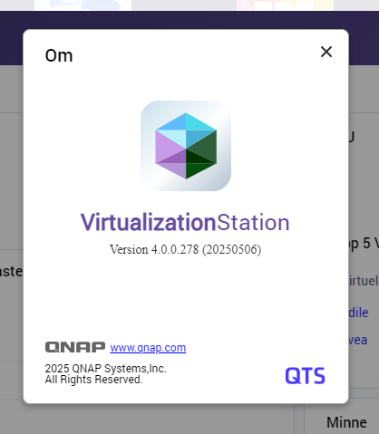

Thank you Becker, I am running 4.0.0.278 so I guess it would make sense to upgrade to .280
I’ll do that and see if it goes away.
Thanks again!
Nope, that did not work for me.
I tried to install the .280 version but it always failed with an error message stating there should be more info in the log. The log was empty though.
I was on .278 to start with.
My upgrade path:
I didn’t read all the entries in the other thread so I tried to install it manually “on top” of the .278. That failed and the .278 was restarted again.
I removed .278 and tried again, but it failed the same way again.
I reinstalled .278 and that worked; with the same log-errors as before.
Anything else i can try to get it upgraded?

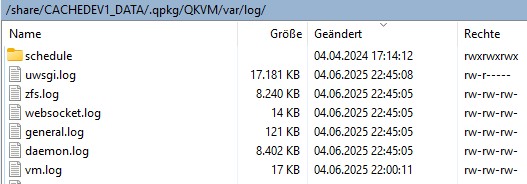

I think QNAP found the problem with VS 4.0.0.278.
With VS 4.0.0.280 the “zfs-problem” is gone.
NAS: TS-264, QTS 5.2.5.3145
VS 4.0.0.278
zfs.log
2025-05-20:16:21:53.68 16451 err [zfs::list_qrecv:565] zfs qrecv list --json failed: [Errno 2] No such file or directory: ‘/sbin/zfs’
2025-05-20:16:21:54.72 16451 err [zfs::list_qrecv:565] zfs qrecv list --json failed: [Errno 2] No such file or directory: ‘/sbin/zfs’
2025-05-20:16:21:55.75 16451 err [zfs::list_qrecv:565] zfs qrecv list --json failed: [Errno 2] No such file or directory: ‘/sbin/zfs’
2025-05-20:16:21:56.78 16451 err [zfs::list_qrecv:565] zfs qrecv list --json failed: [Errno 2] No such file or directory: ‘/sbin/zfs’
2025-05-20:16:21:57.81 16451 err [zfs::list_qrecv:565] zfs qrecv list --json failed: [Errno 2] No such file or directory: ‘/sbin/zfs’
2025-05-20:16:21:58.86 16451 err [zfs::list_qrecv:565] zfs qrecv list --json failed: [Errno 2] No such file or directory: ‘/sbin/zfs’
2025-05-20:16:21:59.90 16451 err [zfs::list_qrecv:565] zfs qrecv list --json failed: [Errno 2] No such file or directory: ‘/sbin/zfs’
2025-05-20:16:22:00.94 16451 err [zfs::list_qrecv:565] zfs qrecv list --json failed: [Errno 2] No such file or directory: ‘/sbin/zfs’
2025-05-20:16:22:01.98 16451 err [zfs::list_qrecv:565] zfs qrecv list --json failed: [Errno 2] No such file or directory: ‘/sbin/zfs’
2025-05-20:16:22:03.04 16451 err [zfs::list_qrecv:565] zfs qrecv list --json failed: [Errno 2] No such file or directory: ‘/sbin/zfs’
2025-05-20:16:22:04.08 16451 err [zfs::list_qrecv:565] zfs qrecv list --json failed: [Errno 2] No such file or directory: ‘/sbin/zfs’
2025-05-20:16:22:05.15 16451 err [zfs::list_qrecv:565] zfs qrecv list --json failed: [Errno 2] No such file or directory: ‘/sbin/zfs’
2025-05-20:16:22:06.20 16451 err [zfs::list_qrecv:565] zfs qrecv list --json failed: [Errno 2] No such file or directory: ‘/sbin/zfs’
uwsgi.log
2025-06-04:20:46:31.32 18437 err [qrecvmanager:QrecvManager:forever:74] qrecv manager error: ‘NoneType’ object has no attribute ‘items’
2025-06-04:20:46:32.33 18437 err [zfs::list_qrecv:565] zfs qrecv list --json failed: [Errno 2] No such file or directory: ‘/sbin/zfs’
2025-06-04:20:46:32.33 18437 err [qrecvmanager:QrecvManager:forever:74] qrecv manager error: ‘NoneType’ object has no attribute ‘items’
2025-06-04:20:46:33.34 18437 err [zfs::list_qrecv:565] zfs qrecv list --json failed: [Errno 2] No such file or directory: ‘/sbin/zfs’
2025-06-04:20:46:33.34 18437 err [qrecvmanager:QrecvManager:forever:74] qrecv manager error: ‘NoneType’ object has no attribute ‘items’
2025-06-04:20:46:34.35 18437 err [zfs::list_qrecv:565] zfs qrecv list --json failed: [Errno 2] No such file or directory: ‘/sbin/zfs’
2025-06-04:20:46:34.35 18437 err [qrecvmanager:QrecvManager:forever:74] qrecv manager error: ‘NoneType’ object has no attribute ‘items’

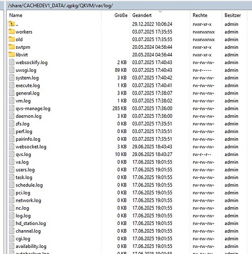

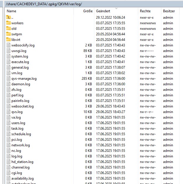

VS 4.0.0.280
zfs.log
emty
uwsgi.log
2025-07-03:15:40:41.94 24932 err [commands::execute_with_retry:41] Attempt 3 of 3: ret=1
2025-07-03:15:40:42.95 24932 err [utils::get_hero_ha_status:372] ret=1 err=‘’
03/Jul/2025:15:40:43 +0000 GET /qvs/vms/1 HTTP/1.1 200 from 192.168.2.21
03/Jul/2025:15:40:43 +0000 GET /qvs/static/vendors.js?t=1751557294779 HTTP/1.1 200 from -
