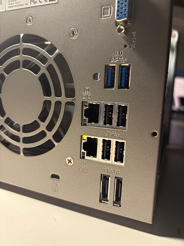

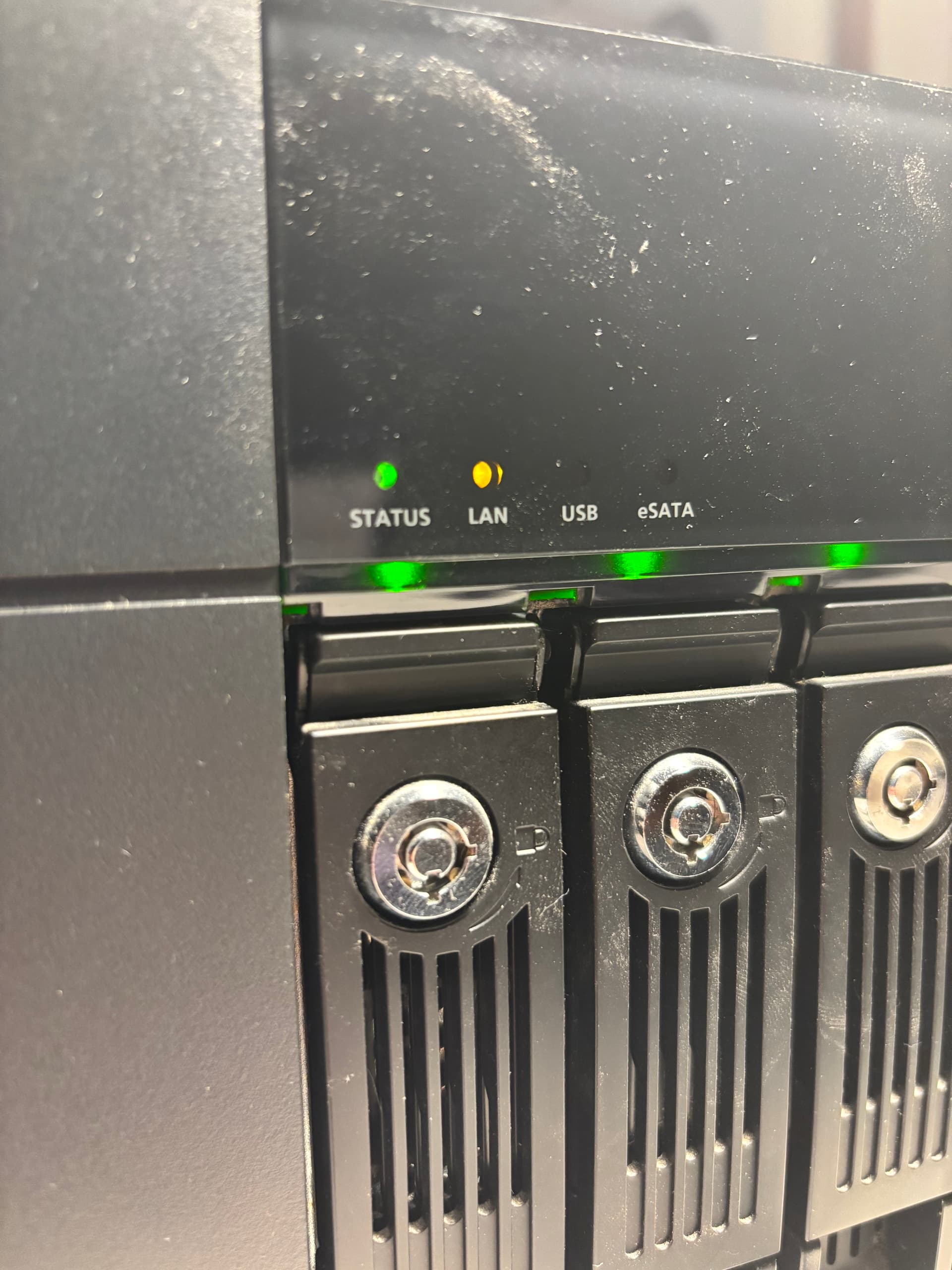

From the hardware side, the only thing that might be related to this problem is the fact that the “LAN” led stays always on steady yellow (even though the LAN cable is not plugged in) and the second ethernet port also has the upper led on steady yellow (even though nothing is attached).

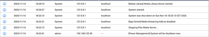

Note that I pressed on “shut down” approximately at 18:22:00 and in ~1:30 minutes [18:23:30] it shut down. After more or less 2 seconds, it started booting again emitting the startup beep after ~15 seconds [18:23:45]. On the display it showed “SYSTEM BOOTING” for ~2:45 minutes [18:26:30], then “LOADING DRIVER” for ~30 seconds [18:27:00], then “MOUNT VOLUME” for ~30 seconds [18:27:30], then “STARTING SERVICE” for ~1:20 minutes [18:28:50] and then emitted the second startup beep.
