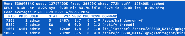

Don’t look at the CPU usage. Look at the Load Average. They are different. Load Average is not average CPU usage. It’s more of a measure of the number of threads running or waiting to run on the CPU. For my TS-873A, the Ryzen has 4 cores with 8 threads. That means it can handle 8 threads simultaneously at any time. If a thread takes a long time to execute, it may not be using a lot of CPU time, but it is still sitting there taking up clock cycles. So if you have a load average of say, 20, that means there’s like 12 threads sitting in the queue waiting to execute. This is why things can get really really slow. I don’t know if your container is causing this to happen, but it could be something else on your NAS.
Your TS-453 has an Intel J6412 process with 4 cores and 4 threads. Truthfully, this is a pretty low end processor (better than an A57 but way below an i5 or i7). Unfortunately, most NAS units have fairly low end processors in them. That’s why you can buy one new for a few hundred dollars. They work fine for basic file serving, but when you start running more and more applications on them, they start crawling.
A lot of them are running A55 or A57 ARM core processors. Those are great cores for an embedded application but honestly, not for a NAS.

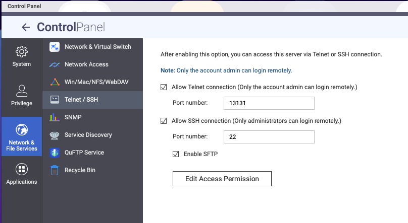

How do I check the load exactly?
1.) Make sure you has SSH enabled.
2.) From a command prompt on your computer (terminal in Mac or the DOS shell in Windows) type:
ssh username@NAS_IP
Where username is your username on the NAS and NAS_IP is the IP of the NAS. in my case:
ssh jono@192.168.0.1
If you are asked to add the machine to the list of secure hosts say yes.
Enter your password when prompted.
This gets you into the Linux shell of the NAS. Type the word “top” without quotes. This will show you the top processes running on the NAS. The load average is the numbers at the top under the CPU percentages:
Keep logged in here and take a look at that number when your NAS goes berserk.
