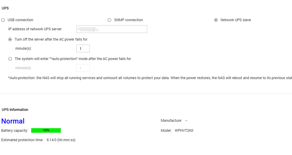

Could you please try setting up the NUT Slave via our UI? Or is there a particular reason why you can’t set it up directly through the UI?
Regarding the issue with using a command, I’ll be forwarding that to our internal team for analysis. Thanks for the report!
Finally, it strarted obeying the BL status and starts the timer defined in the UI, it wasn’t working before (maybe needed a roboot apart form apply button)
but I want to trigger an FSD at given moment, I don’t want a nattery event timer, I set it in the UI to 100 minutes so it won’t distub.
I want it to obey upsmon -fsd from master, which is not currently
I could do it with dummy-ups and give 0 minutes timer, but UI won’t let me.

QNAP’s own GUI option for this — Control Panel → System → Power → UPS → “Network UPS slave” — only asks for the server’s IP address. There’s no username/password field.
Real NUT MONITOR connections (the ones that register a device as an authenticated client and allow proper shutdown coordination) require credentials matching an entry in the server’s upsd.users. Without that, QNAP’s GUI-driven process (upsutil) can’t fully authenticate, so:
  • The NAS never appeared in the NUT server’s connected-clients list.
  • The GUI’s own UPS Information fields stayed blank (AC power status, battery capacity, model — all showed --), even though the UPS was clearly online.
