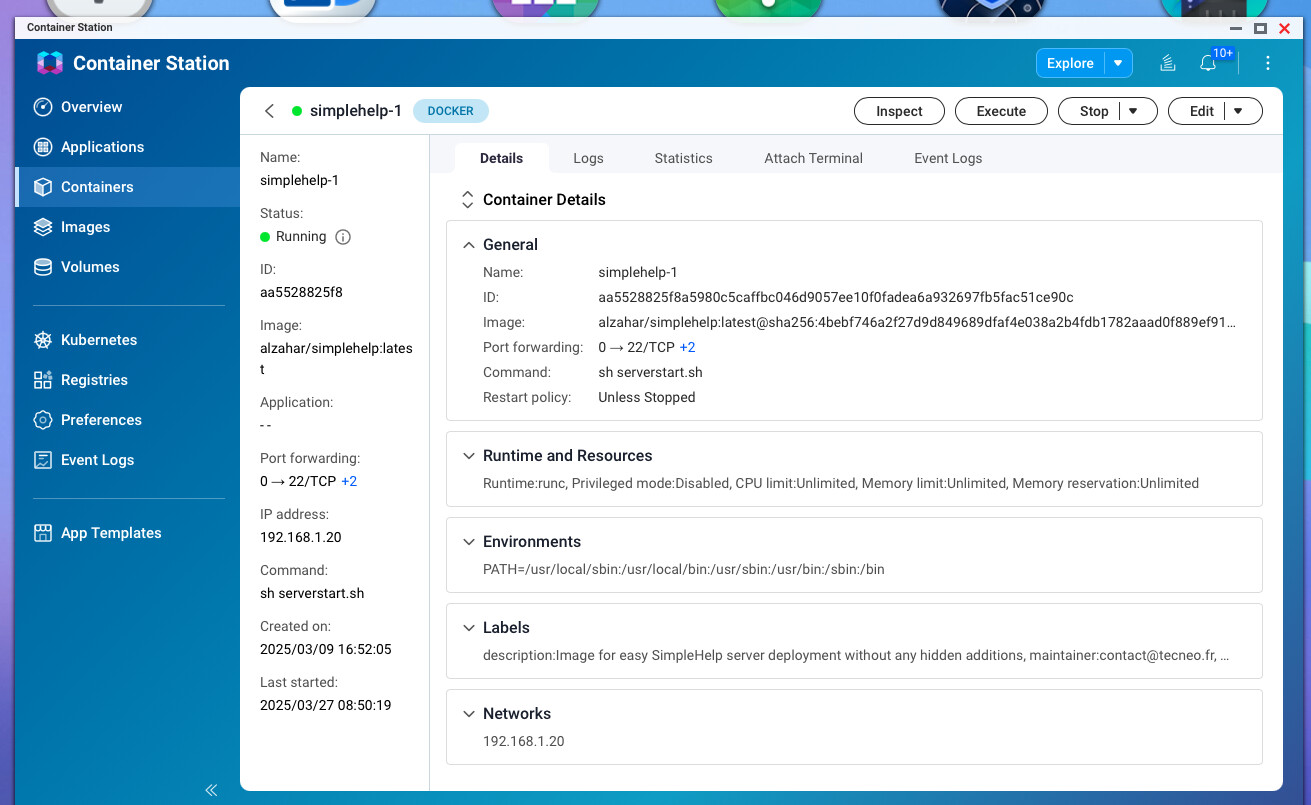

I have a support application, SimpleHelp, that I am running in a Docker Container in Container Station. It works great except I have one problem. I am not able to update the SimpleHelp software as new releases come out. Sure, I could create a new container but that is tedious doing that every time and recreating all my preferences, etc.
What I want to be able to do is either access the file inside the container or set the container up so that I can utilize a directory on my NAS. I’ve been trying to figure out how to do this by creating a volume with the container, but it’s not clear and I keep running into roadblocks because when you create a volume it wants a container name and every container name I enter is an invalid path. So I’m stuck.

Now is there any way to read existing container files from the NAS? I’ve not been able to figure that out. Not possible?

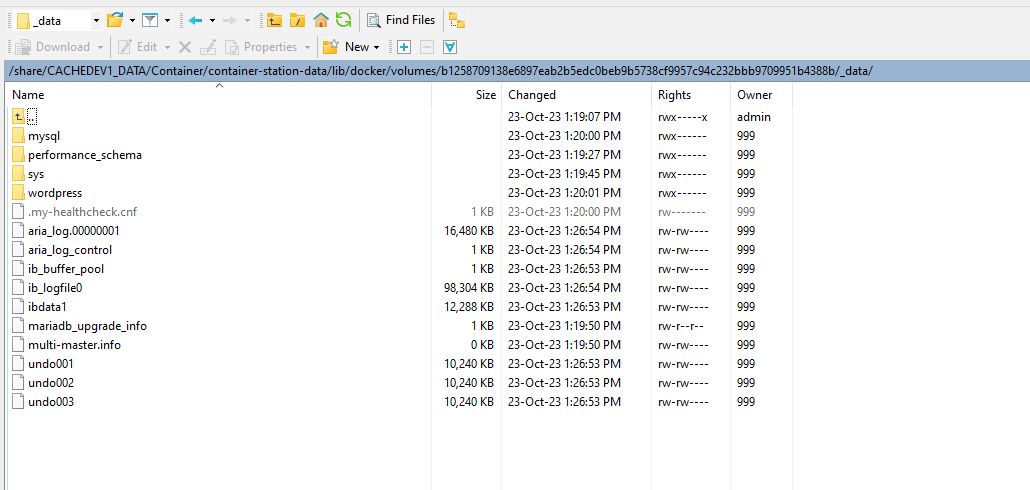

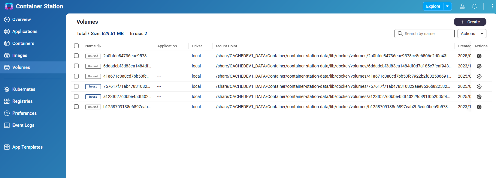

You can browse to the created volumes via WinSCP (for easy GUI) and just go to location shown here
Yeah, I have no volumes with my current container. I just used the wizard to create it from the repository.
In File Station I can go into:
/Container/container-station-data/lib/docker/containers/aa5528825f8a5980c5caffbc046d9057ee10f0fadea6a932697fb5fac51ce90c
But there’s nothing useful in there. Is that where I need WinSCP?

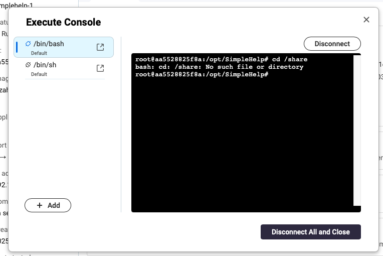

hmm … you can try to add a container SSH session and try to connect to the container directly (should also work via SSH)
I can get a console for the container but I can’t figure out how to get outside of it…

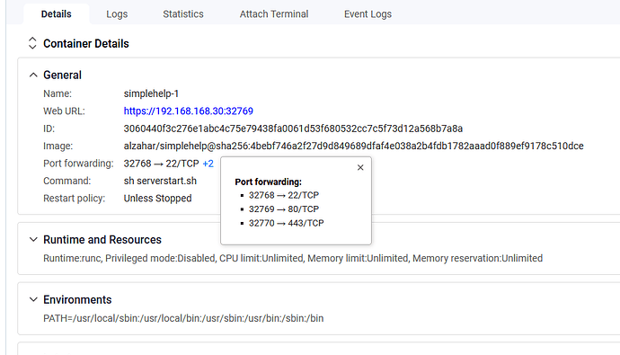

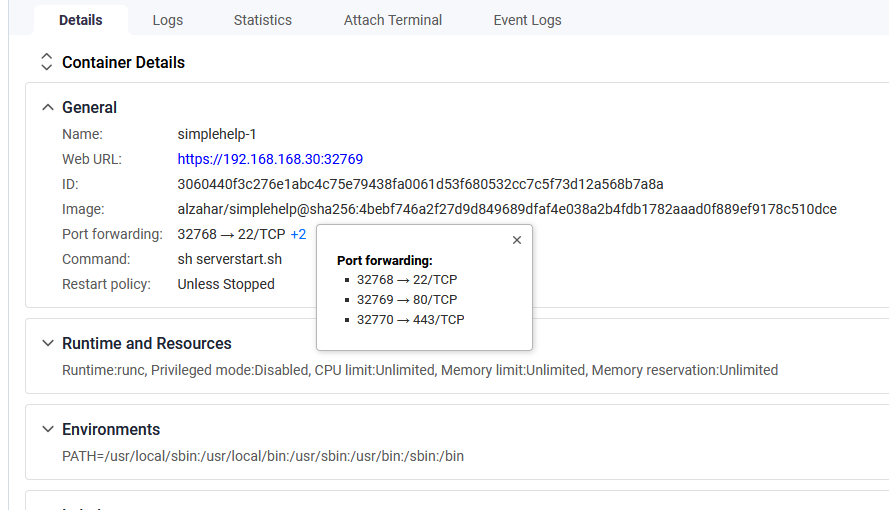

I downloaded the same docker image you used and the default install had 3 NAT port mappings included
SSH
HTTP
HTTPS
See if you can connect to SSH via that

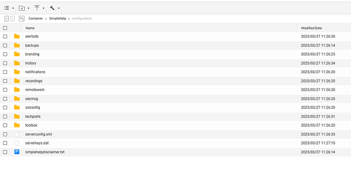

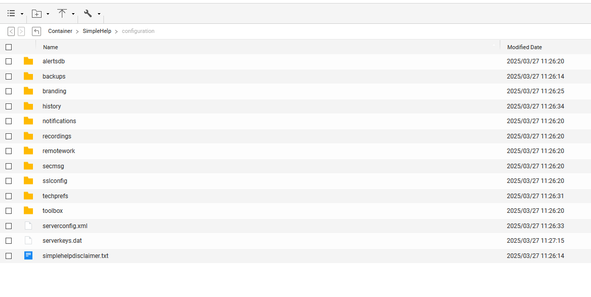

Works fine here when I remove that networking section (it was already defined further up as NAT anyways)
services:
#SimpleHelp Container
  simplehelp:
    image: tecneo/simplehelp
    container_name : simplehelp
    ports:
      - "8680:80"
      - "8681:80/udp"
      - "8643:443"
      - "8643:443/udp"
    volumes:
      - /etc/timezone:/etc/timezone:ro
      - /etc/localtime:/etc/localtime:ro
      - /share/Container/SimpleHelp/configuration:/opt/SimpleHelp/configuration
    restart: unless-stopped
    labels:
      - "traefik.enable=true"
      - "traefik.http.routers.simplehelp.rule=Host(`SUBDOMAIN.DOMAIN.EXT`)"
      - "traefik.http.routers.simplehelp.entrypoints=web,websecure"
      - "traefik.http.routers.simplehelp.tls.certresolver=myresolver"
      - "traefik.http.services.simplehelp.loadbalancer.server.port=80"
      - "traefik.udp.routers.simplehelp-udp.entrypoints=webudp"
      - "traefik.udp.routers.simplehelp-udp.service=simplehelp"
      - "traefik.udp.services.simplehelp.loadbalancer.server.port=80"
The configuration folder gets successfully filled here for me
