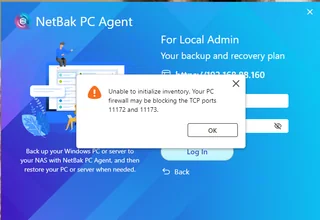

However, NetBack then says:
“Unable to initialize inventory. Your PC firewall may be blocking the TCP ports 11172 and 11173”
I’ve checked the firewall on the NAS and it’s configured to allow all local traffic. I’ve also added an additional rule to allow traffic from the TailScale IP address of the 2nd PC in the 2nd location, but it still won’t work.
It’s not the firewall on the 2nd PC in the 2nd location either as I turned it off.
How can I use NetBack on the PC in my home, but I cannot use NetBack on a 2nd PC in a 2nd location that is on the same virtual network? Even though it can see the NAS and log into it?
