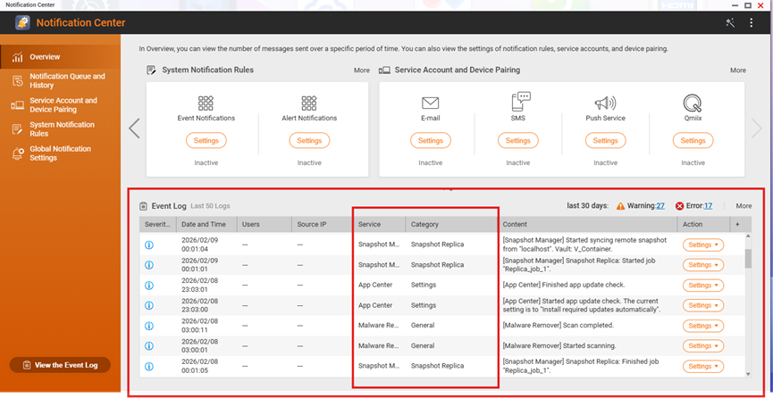

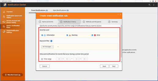

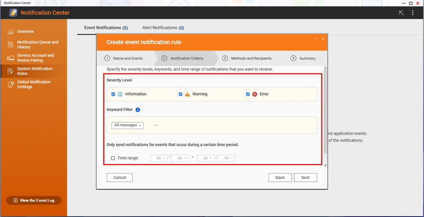

In the Notification Center events rules I set for all of them only the Warning and Errors severity, but nevertheless for some of them (QuFirewall, AppCenter, Malware Remover, Antivirus) I receive also all the Info messages, which are a lot, and completely useless.

Hi, thanks for the feedback. To help us better understand your configuration, could you please provide a screenshot of your Notification Center settings page?
Additionally, could you share some specific examples or screenshots of the “Info messages” notifications you mentioned? This will be very helpful for our investigation. Thanks!

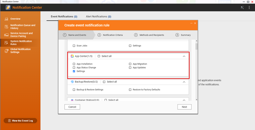

Hi, problem solved…

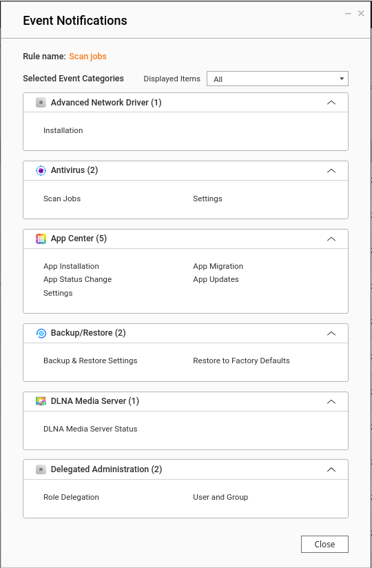

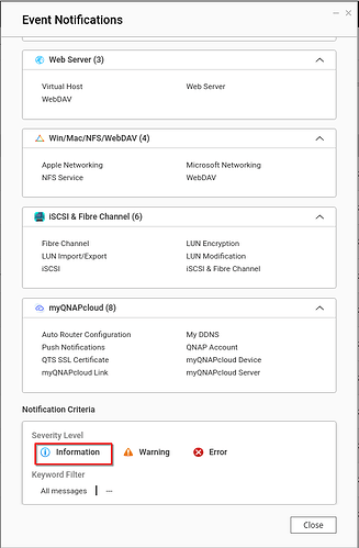

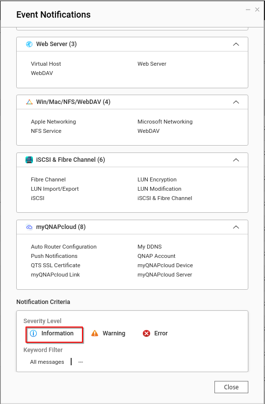

My mistake, sorry for that; revising the events rules I realized there was one (Scan Jobs, see the pictures) which actually had the Info severity checked. After removing it, no more info messages :man_facepalming:
Honestly speaking, I don’t know if it makes sense to have such a rule: in which sense it is different from the app rules themselves?
