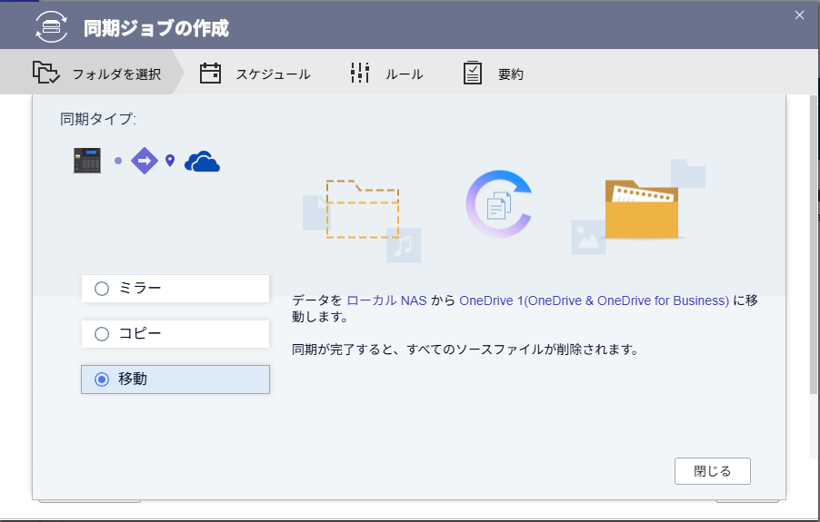

Yes, I think it’s fine to use HBS3 for synchronization.
If the NAS capacity is >= OneDrive, then synchronizing with HBS3 should be fine.

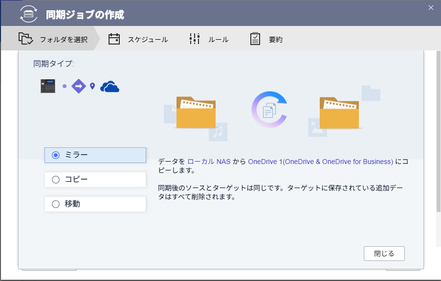

If the NAS capacity is < OneDrive, it might also be an option to use HybridMount to upload to OneDrive. When synchronizing with HBS3, you can choose to sync by copying or moving.
Do you need to keep data one-to-one between OneDrive and on-premises?
Is it enough just to send data to OneDrive?
Do you need to access the data sent to OneDrive from the NAS?
If you clarify these points, I think it will become clear which method is best.

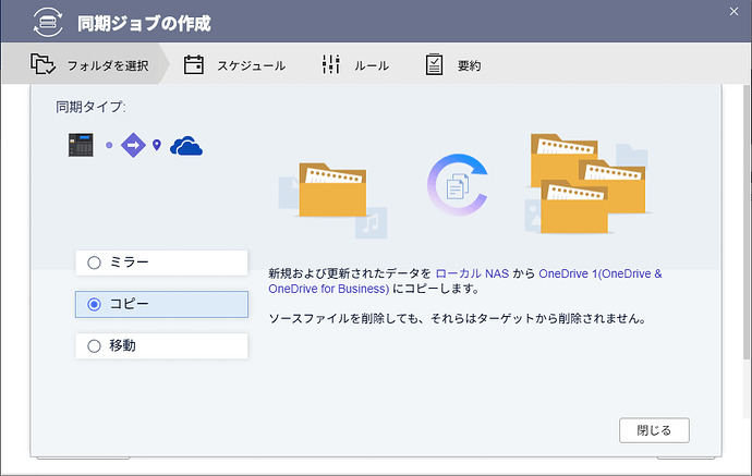

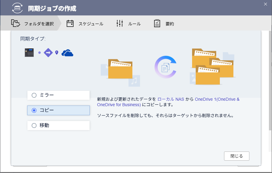

Thank you so much for even providing a screenshot!
Considering the intended use, it seems that using HBS3 would be a good choice.
At present, there’s no need for a strict one-to-one correspondence between the Onedrive side and the on-premises side (since Onedrive is mainly used for backup and data is only restored during recovery), so I felt that creating a sync job with copy, taking into account restoration during recovery, would be the best approach.
