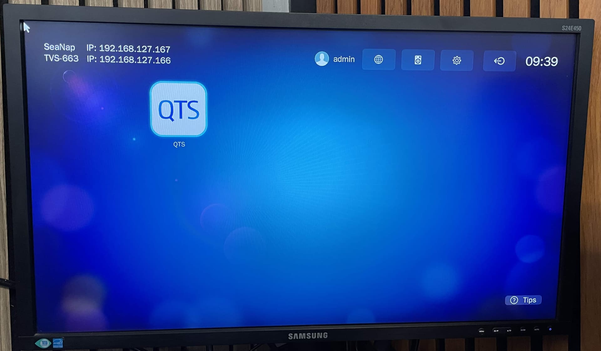

Screen 1 - Screen QNAP boots to

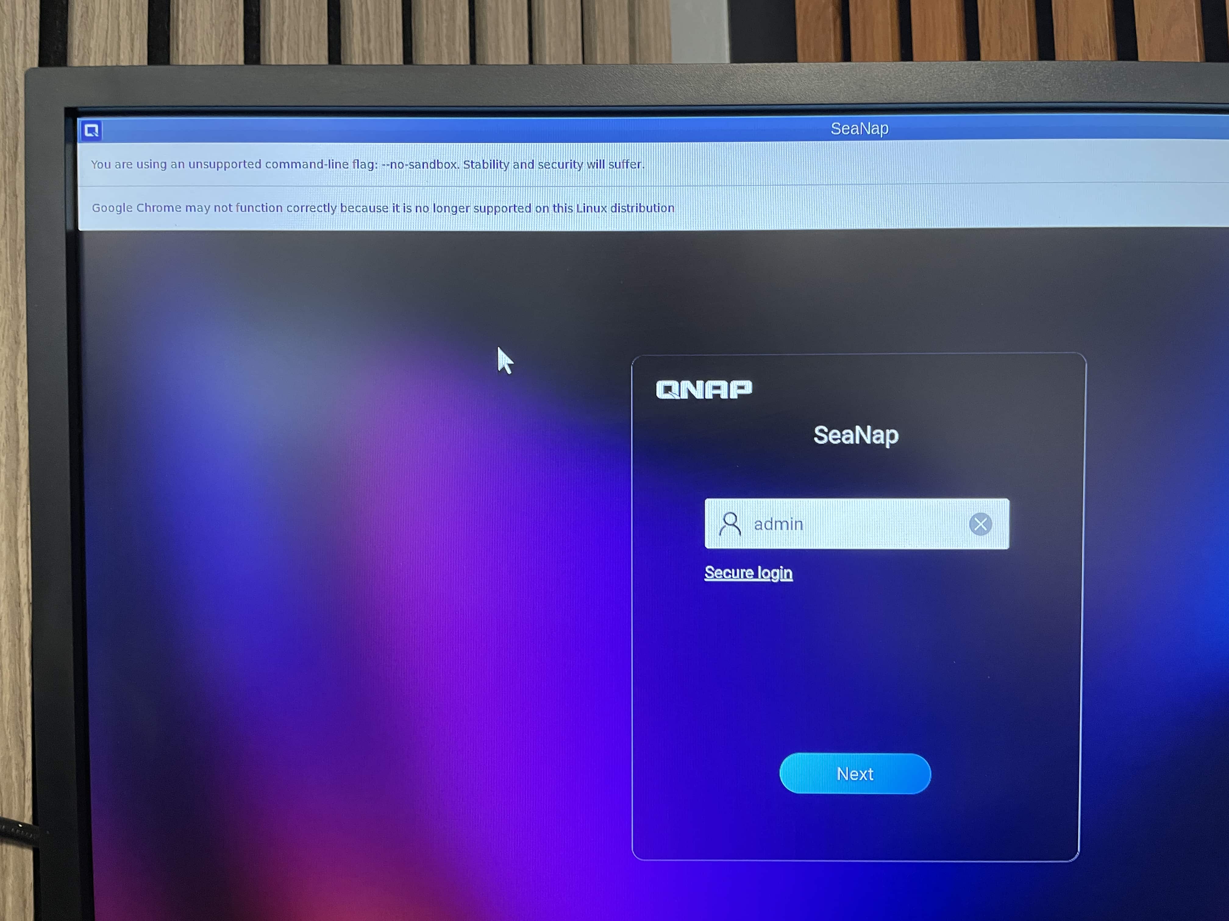

Screen 2 - Clicked on QTS to log in

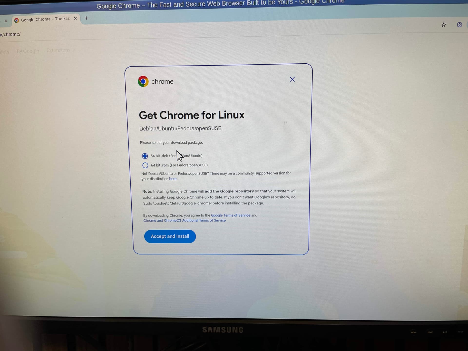

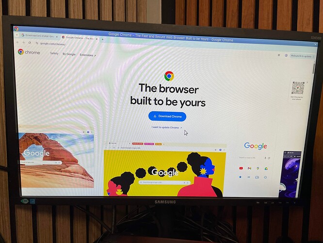

Screen 3 - I’ve missed 1 screen, a POP UP comes up bottom right has click here to update chrome, so I click that and get to this screen
Screen 4 - The .DEB package is selected for download

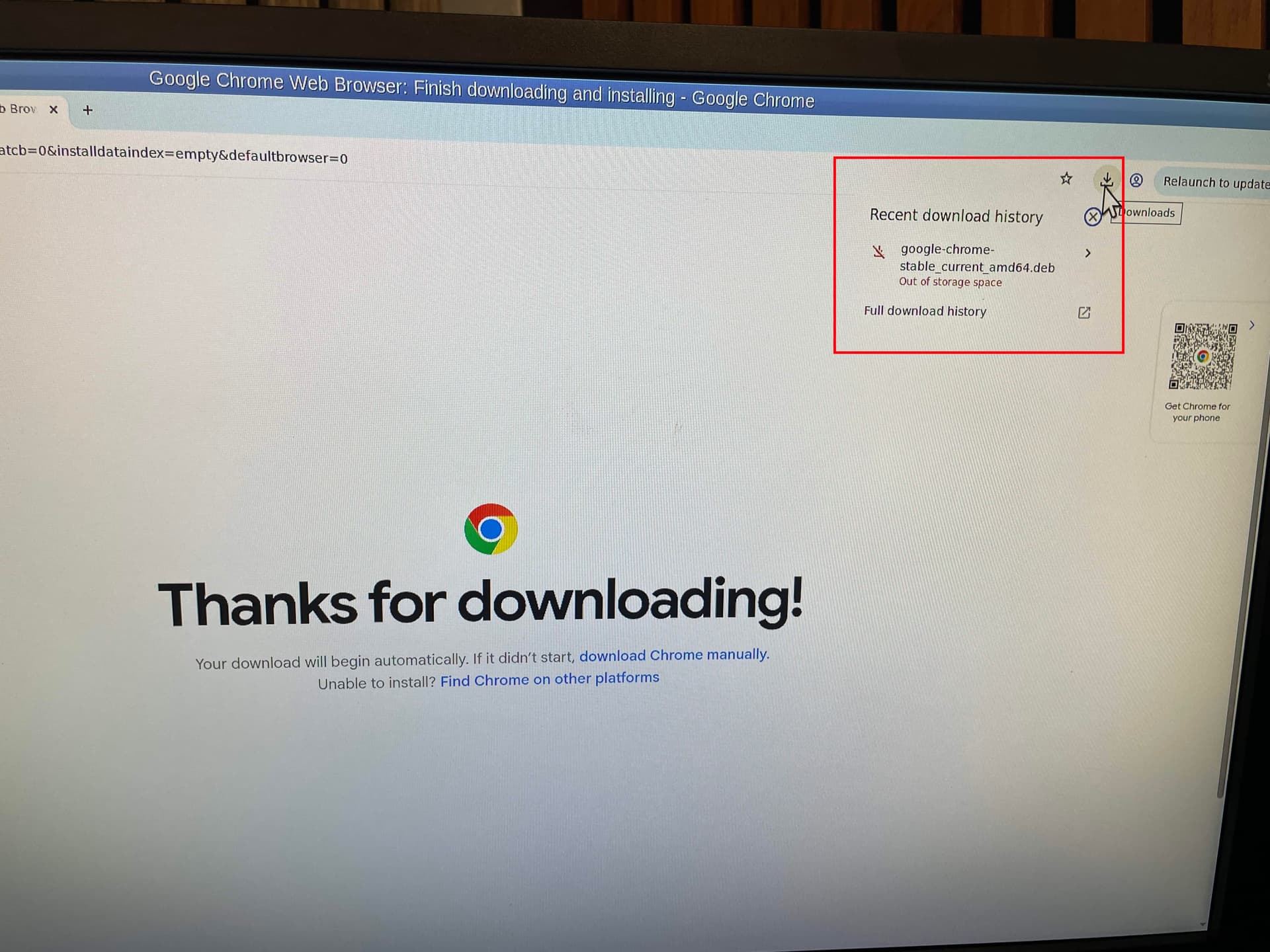

Screen 5 - Download fails as no storage
