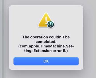

After upgrading my TS-873A to Hero 5.3 I started having a problem with TimeMachine backups on one of my Macs. I cannot connect to my TimeMachine folder. I get an error. The other Mac works fine. And researching this problem only shows that it has to do with permissions and TimeMachine is very finicky about this sort of thing. So I opened an SSH session and looked at the permissions of my TimeMachine folder on the NAS. This is what I see:

Thanks, guys. Unfortunately, I am not sure that’s the issue either. I renamed my TimeMachine sparse bundle to try to force TimeMachine to create a new one when it mounts the drive. It just won’t mount the drive. It sees it but gets an error when mounting it. And I’m not using a “new” Mac OS here. It’s Sonoma on my Mac mini but I’m running Sequoia on my laptop and it works fine. So I am rather perplexed about why I cannot mount the network share for TimeMachine…

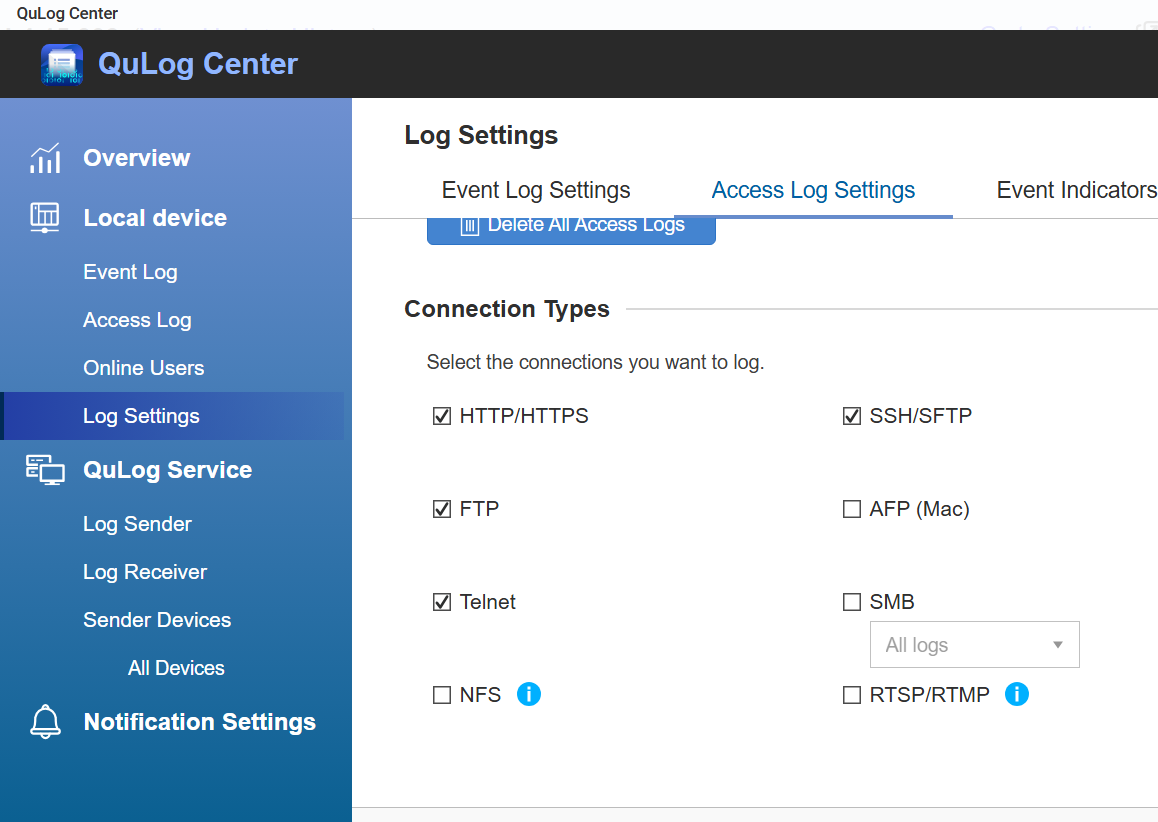

Debug level logging maybe?
I’ll have to try but I don’t think it’s going to be anything that QNAP will tell me. From what I can tell, it’s logging into the NAS and seeing. It just won’t mount the share in Time Machine. Gives an error:
SMB1 is enabled as my Sonos system needs that.
Searches on this error are all about permissions, but from what I can tell, the permissions on the shared folder are fine - why would one Mac be able to access and the other can’t? So that doesn’t make sense. Apple in all their wisdom has made Time Machine a pain to troubleshoot. Reboot of the Mac didn’t help either.
