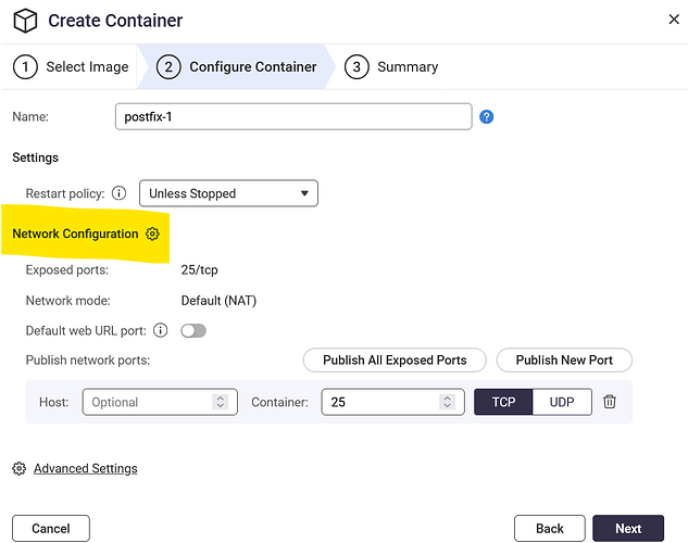

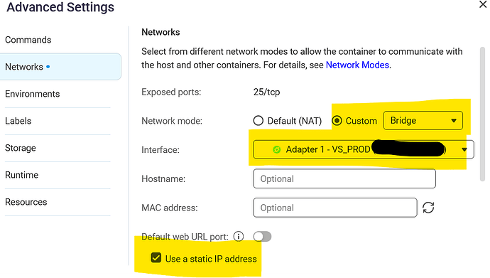

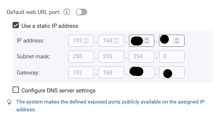

You can put the containers into Bridge mode where they then are attached to a particular network adapter. You can then assign them fixed IPs.
for static on standard container, you can set up ip under networking but it will be bridged.

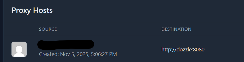

I know under application with using a compose you can reference by app name as long as the containers are all in the same networking. I do this for nginx-proxy-manager. below is a sample compose yaml for npm and another app dozzle. I think i had to create the network backendApps using docker command, i dont recall. The npm isnt complete btw, it just showing use of two networks. All my other apps are just in the backendApps and NPM provides reverse proxy and https.

how to reference in npm
