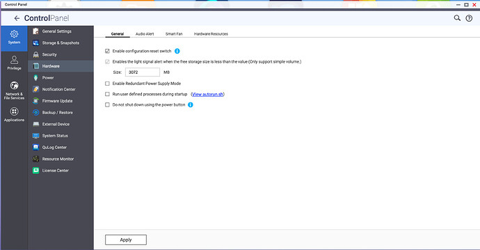

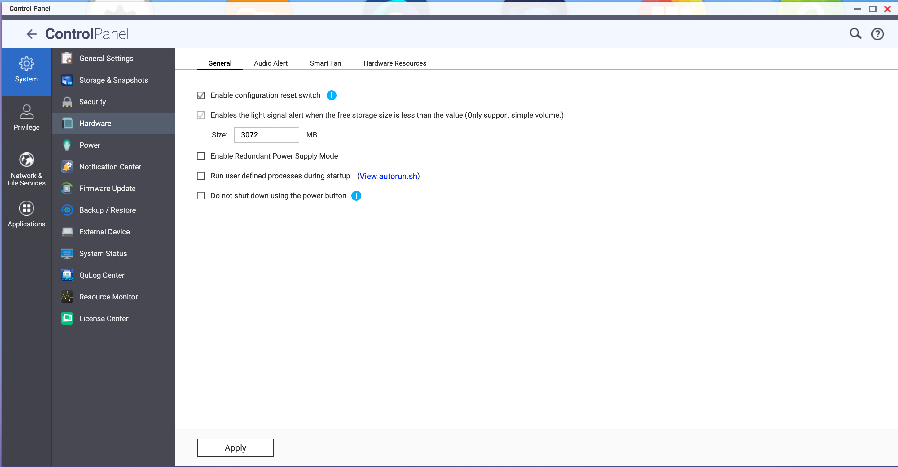

However as I mentioned in my post I don’t have that option (see photo).
My research suggests the option was taken out of NVMe based units like the TS-h2490FU due to not being needed. Shouldn’t the option re-appear when spindle drives are present in an expansion enclosure? Has this been fixed in a later version of QuTS Hero than what I am running?
