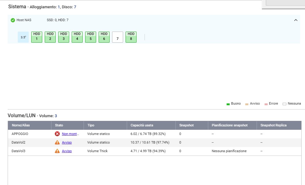

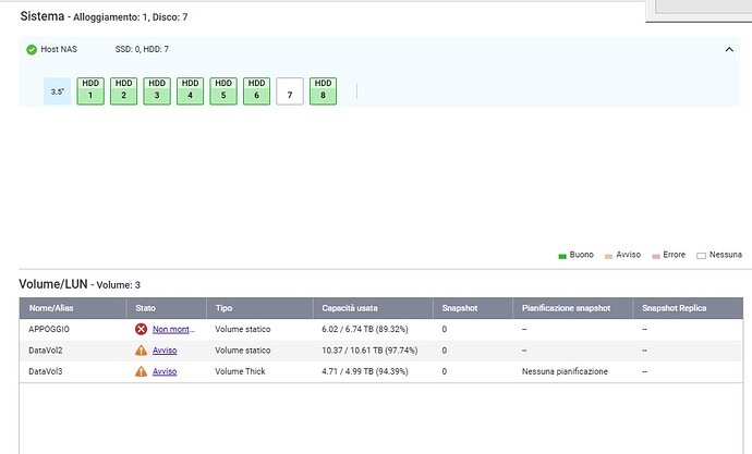

Up until 2 days ago all the disks were in “good” status. Today while I was doing some updates, it went into error and I discovered that it had ejected disk 7. I only noticed (or realized) now that the System label is linked to the Storage Pool used in JBOD. I don’t think I noticed when I added the two disks and made the moves that the system data was there.
Now it tells me to insert a new disk to rebuild the raid.
I tried to connect the disk directly to the PC to read it with LinuxReader but it makes strange noises and is not detected, I will investigate better but I think it is a mechanical and/or controller problem.

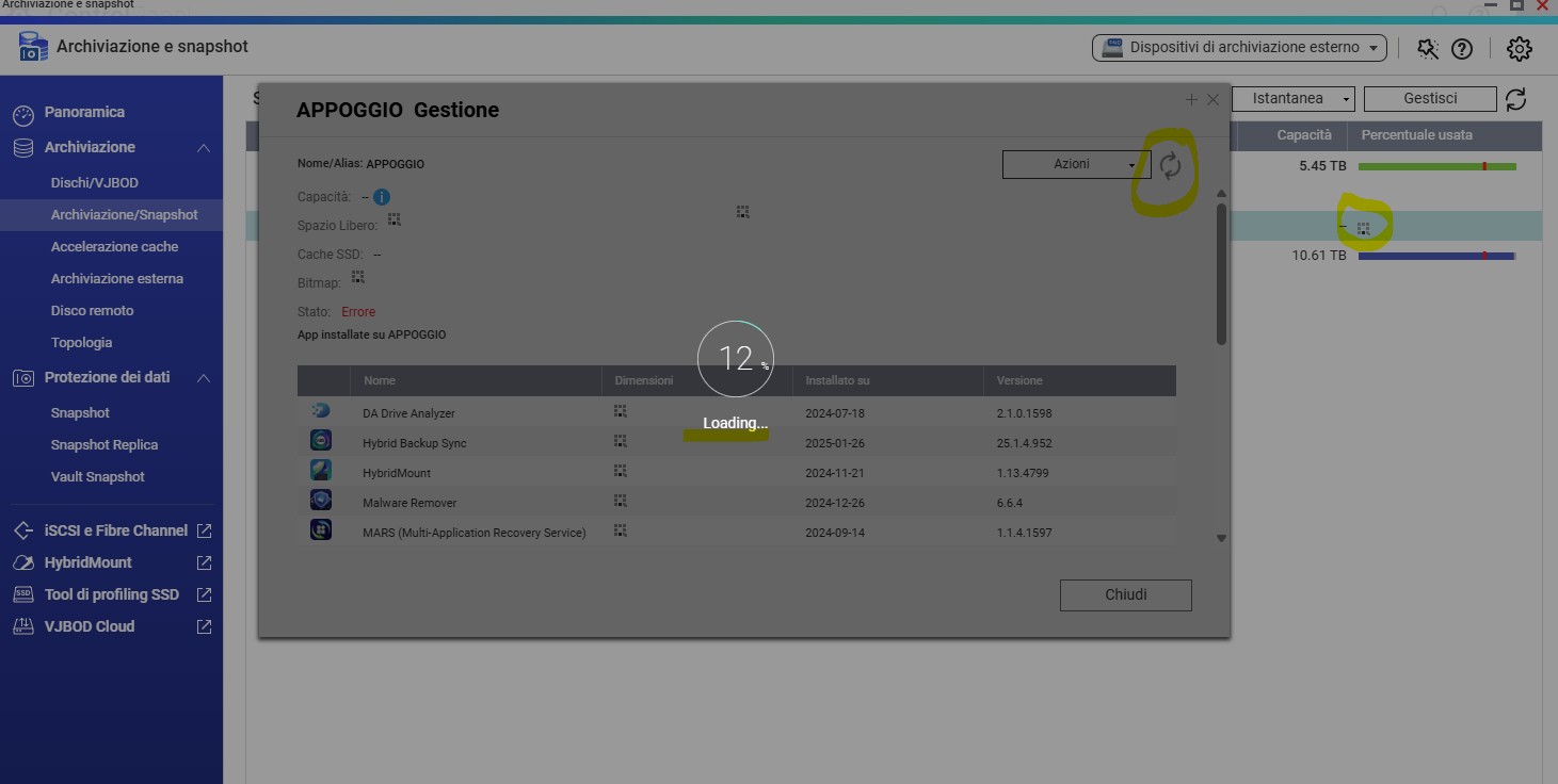

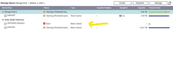

Hi, I’m trying to add a new disk to the working raid5. However, the old JBOD RAID that is no longer working is also present (with an error). When I select it to remove it, the interface gets stuck on the raid data recovery and does not go forward and does not allow me to delete the raid in order to insert a clean disk and add it to the other working raid.
How i can remove the volume?
Disk are removed and interface stuck on 12% of retry volume data.
I would to remove te volume “APPOGGIO” that is BROKEN and that i can’t recover. and the add 2 new disk for create new raid or for now ADD to raid5 that is near the limit.
How i can remove the volume and tell to nas than SYSTEM volume must be DataVol2? And then add new disk and expand DataVol2?
The Spin near APPOGGIO is allways running and if i select the volume for remove it, interface stucks on 12% and action is not enabled.
I suppose the same problem of this
https://forum.qnap.com/viewtopic.php?t=175754
Check the bottom of the linked thread and issue given command via SSH
When the SSH command not work, you can downgrad to QTS 5.2.0 or 5.1.9
With QTS 5.2.0/5.1.9 you can remove the volume

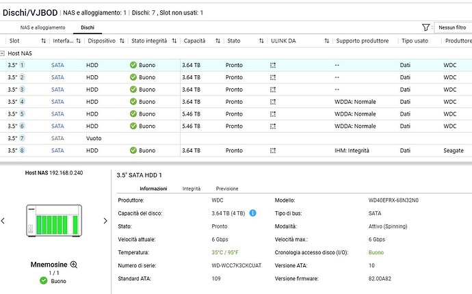

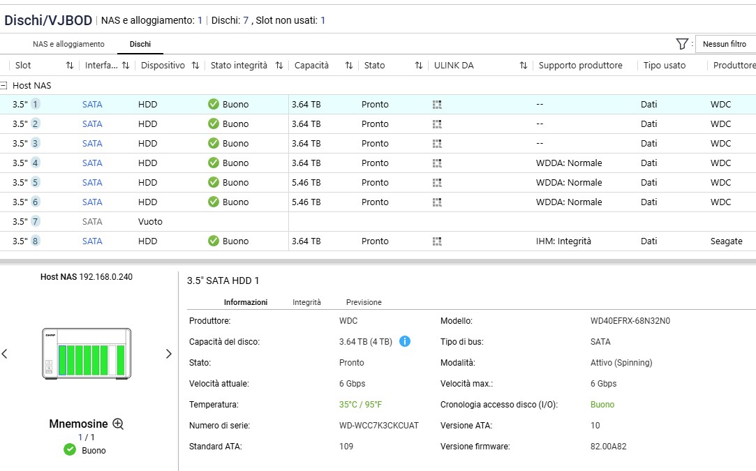

Now I added a new 4TB disk to raid5, so now i have
RAID1 (2x6TB)
Raid5(5x4TB)
1 empty slot.
After the LVM init, i added disk to raid and after 22H the migration ended well.

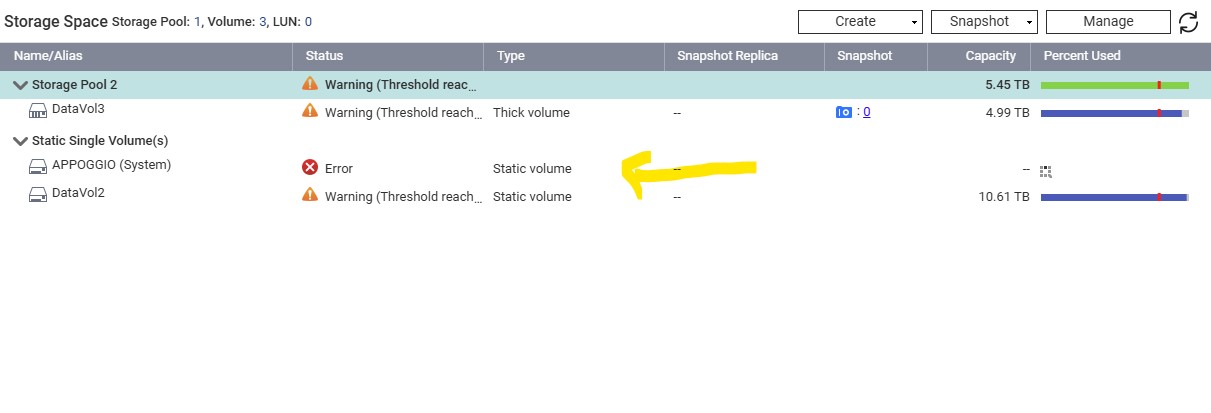

Now the problem is that I don’t have a volume type SYSTEM, and i can add new APP or upgrade existing APp becouse i had no space.
How i can tell to NAS to promote RAID5 to SYSTEM volume?
You can go to
ControlPanel>SharedFolders>Others>RestoreDefaultFolders
That should create the default folders on your volume of choice
Tnx, worked.
Don’t asked me where to create, but now raid5 have the (SYSTEM) label.
Tnx again.
