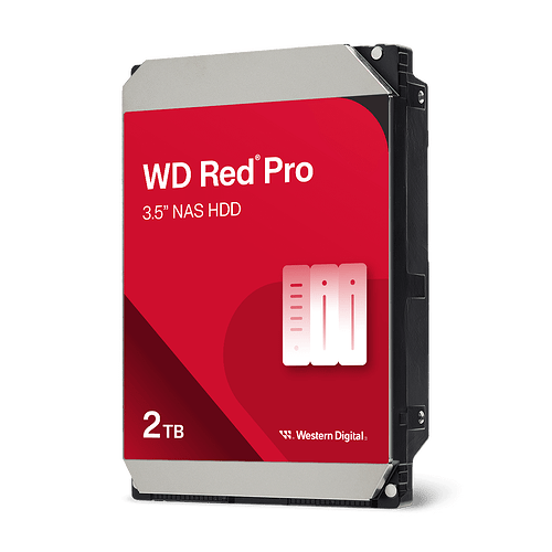

With faster disks (e.g. WD Pro) I would say 500-600MB\s read (RAID5)
WD Pro, but SSD, you mean? Plus, I would still have to upgrade the network module in the NAS, right?

WD Red Pro are spinning disks (speed on spinning disks is varying depending on where the data is on the platters)
The NAS has NVMe slots (Gen3 x2), where you can put a pool on with storage, or you could SATA SSD’s. So there is some configurations, where 10GbE makes sense.
