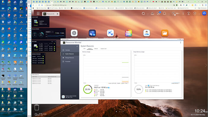

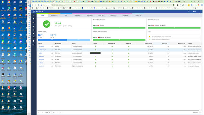

This was reporting correctly when that NAS was on QTS 2 days ago. Showing 4% (lower right) iss 23%.

Your NAS use QTS. 5.2.9.3451
grafik
But QTS has no ZFS-ARC.
What is installed on your NAS ? QTS or QuTShero ?

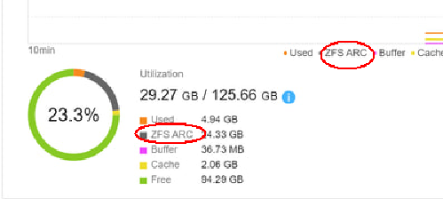

The resource monitor displays under QUTShero for ZFS-ARC and free RAM are incorrect.

QTS 5.29 on the NAS hosting QCenter, QuTS 5.29 on the NAS showing incorrectly.

Thanks for the report! I’ll forward this to our internal team to look into the display issue.
That said, my guess is that this may be a calculation issue — QCenter only counts “Used” memory without factoring in ZFS ARC and similar components, which would explain the 4.94 GB / 125.66 GB reading of approximately 4%.
Either way, I’ll pass this on to our internal team to confirm and look into optimizing it.
It needs to count arc tl be usefull. Today reporting 6% and 23%.
So, since ARC uses cache it is not counted. However, ARC memory settings warns that setting ARC too high can cause apps to shut down, wouldn’t knowing how much was used be important?
Yes, the display inconsistency issue has been submitted to our internal team for evaluation, and they will work on fixing it in a future update. Thank you for the report, and we apologize for any inconvenience caused!
