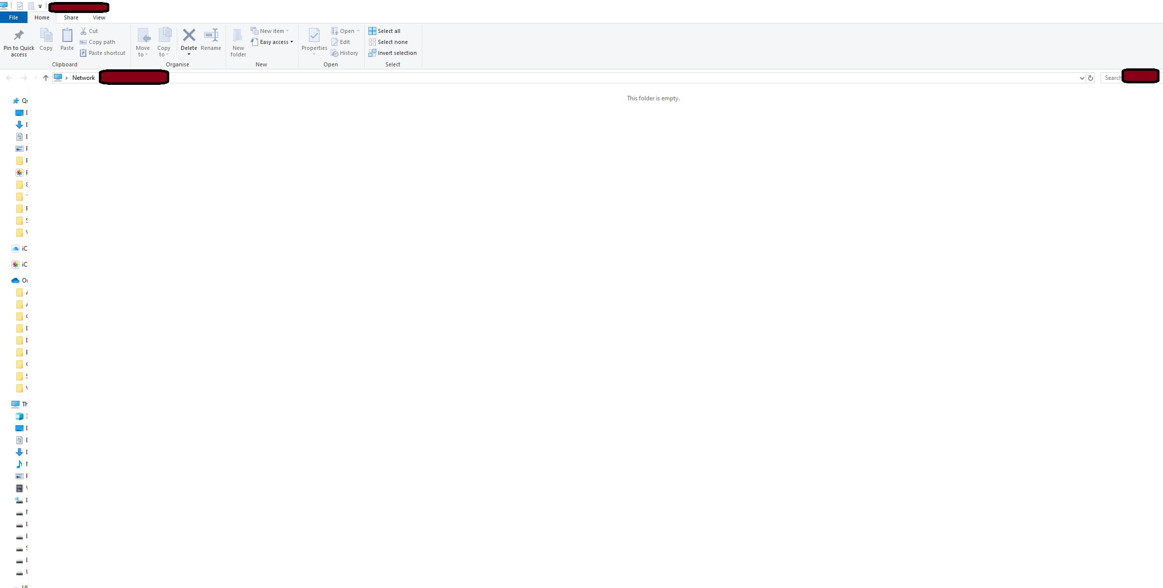

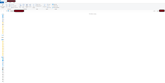

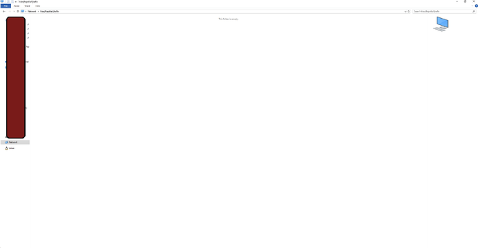

But From Windows 10 PC, I cant see the files or the shared folers using a file exporer or using run command (\19x.x.xx.x) or by the NAS name itself. I only see an empty folder. Not sure why. Have tried restarting and checking the folder permissions and they all have correct access set up.

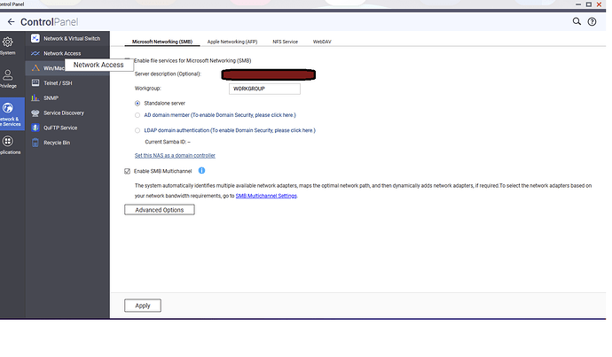

Also on Network Access, All network services/management services / applications are enabled for service binding (Enable service binding option checked).

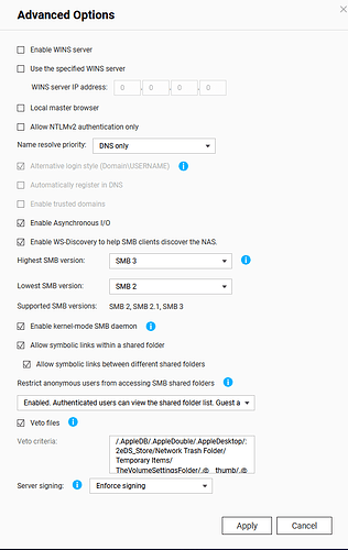

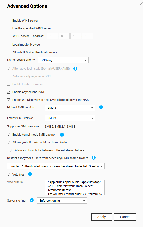

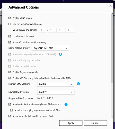

Enable file services for Microsoft Networking (SMB) checked / selected on. On Advanced Options, highest and lowest SMB versions are set correctly.

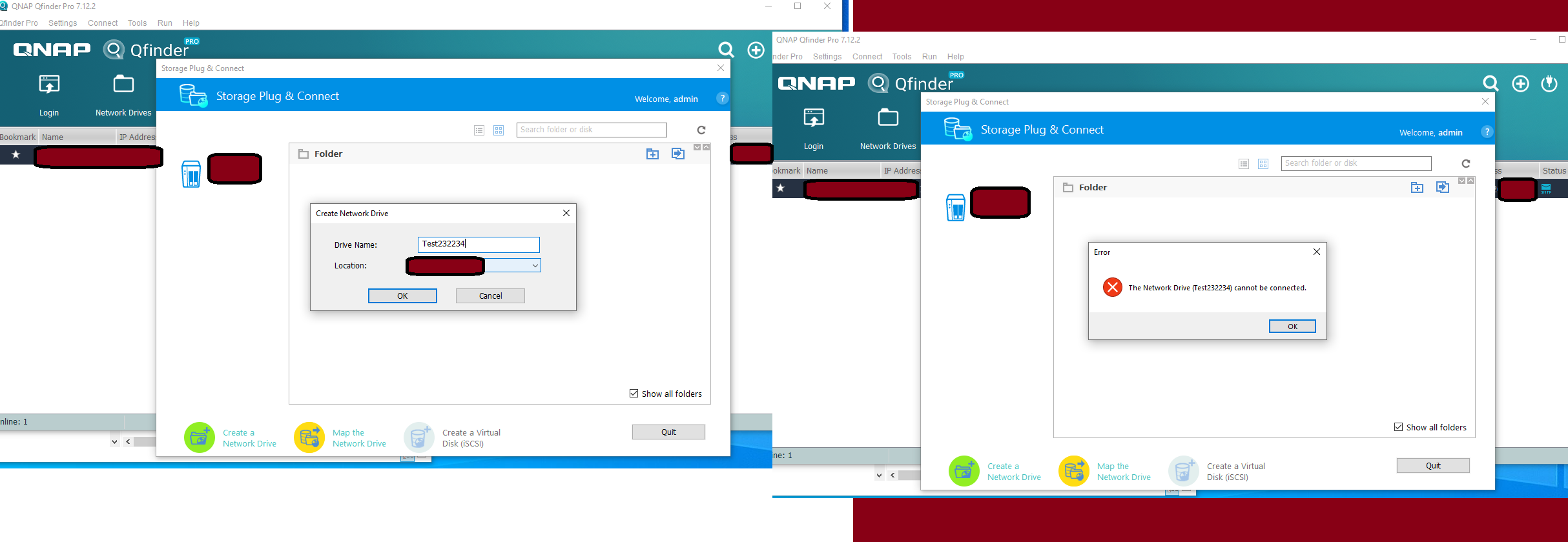

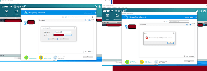

Also when I try to connect via storage Plug & Connect, I can;t find any shared folders here either. But when I create a new folder, the folder gets created on the NAS, but on my PC/desktop it displays a error message that the network drive can’t be connected.

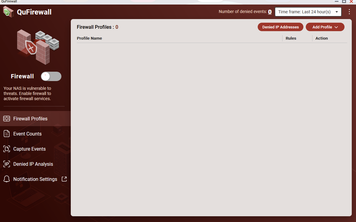

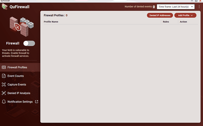

Have you tried to disable any firewalls on the qnap ?
LoL… Sorry about the masking. Have been doing that for years and years, habits dont die…
But with regards to Firewall, it was initially disabled and then I was playing around. Will check again to ensure that is all in place.
BRB
I am unable to enable firewall actually. Unable to switch on the button.
I meant disable or uninstall the firewall
I meant - Firewall is disabled and I am unable to “Enable” it. When I click it, it pops up with a box asking for confirmation to enabling firewall. When I click ok, it does nothing.
Trying to uninstall firewall.

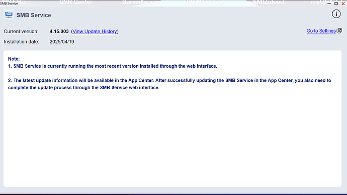

On newer firmware’s the SMB service is actually it’s own program, is that running ok ? (Open it and see what it says)
Here we go - Restarting the NAS after firewall uninstall… But below are the screenshots for the service.
NOt sure what this means - 2. The latest update information will be available in the App Center. After successfully updating the SMB Service in the App Center, you also need to complete the update process through the SMB Service web interface.

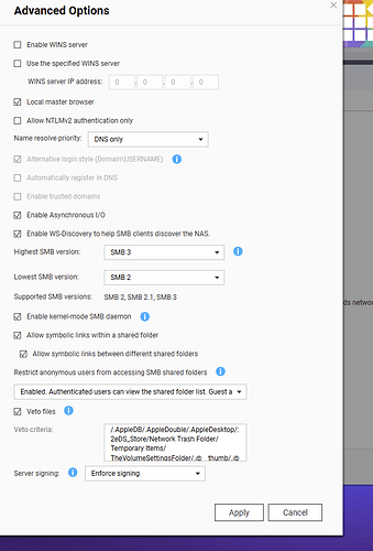

Have you tried enabling “Local Master Browser” in the SMB advanced options?
When the NAS is selected as Local Master Browser there is a chance it would be visible in Network Neighborhood.
But if OP tried to mount \NASNAMEORIP\Sharename, the masterbrowser option should not matter … at least that is what I read between the lines, all this Qfinder stuff was just done because the regular method did not work ? (no?..maybe I am wrong)
I have enabled LMB now. No difference.

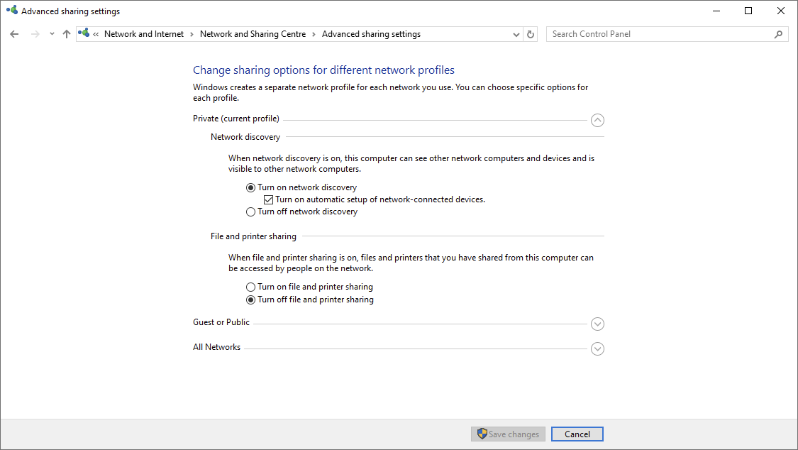

For a fact, I am unable to enable windows option “Turn on file and printer sharing” under Advanced sharing settings
OS = Windows 10

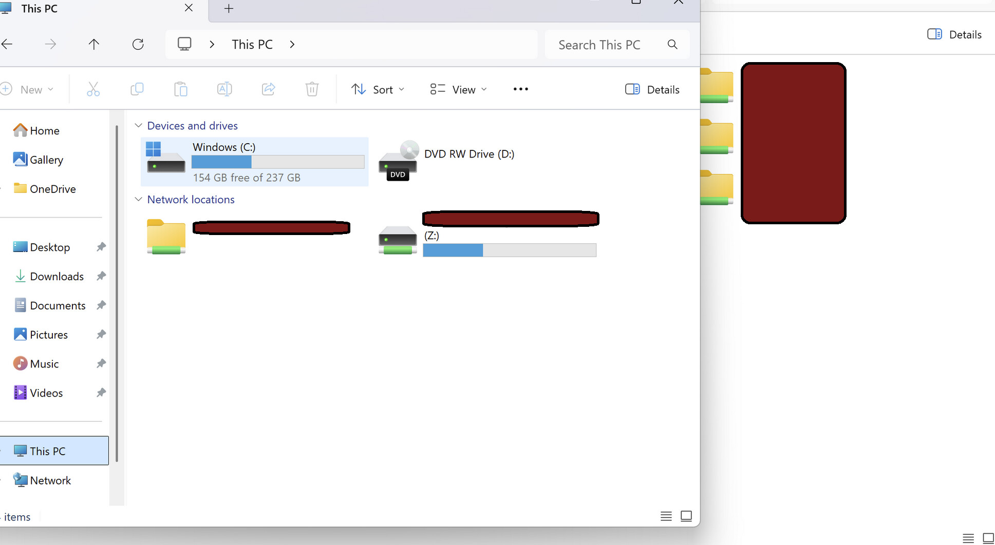

I have another desktop - Which is on Windows 11. Wanted to give a try on that one. So spent 3 hours midnight until 2 AM on it to get this working on Windows 11 -
Got this error message first -
"You can’t access this shared folder because your Organization’s
security policies block unauthenticated guest access. These
policies help protect your PC from unsafe or malicious devices on
the network. "
Added Key AllowInsecureGuestAuth to registry with value as 1. Below are the details -
RegEdit Path = HKEY_LOCAL_MACHINE\SYSTEM\CurrentControlSet\Services\LanmanWorkstation\Parameters
Key (DWORD 32-bit) = AllowInsecureGuestAuth
Then this error "You can’t access this shared folder because your Organization’s security policies block unauthenticated guest access. " disappeared.

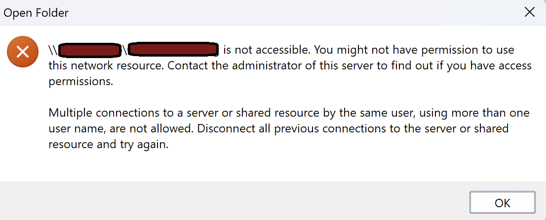

Now when I tried reconnecting(with qnap admin login), I had an different issue / error message -
To resolve the this issue/error(multiple connections to a server or shared resource by the same user), I executed the below 2 commands from command prompt (launch cmd as administrator) one after the other in the same order.
net stop workstation /y
net start workstation
Then I did the same previous action - Connect by giving the folder name along with the server/qnap device name/ip address -
\xxx.xx.x.xx\SharedFolderName.

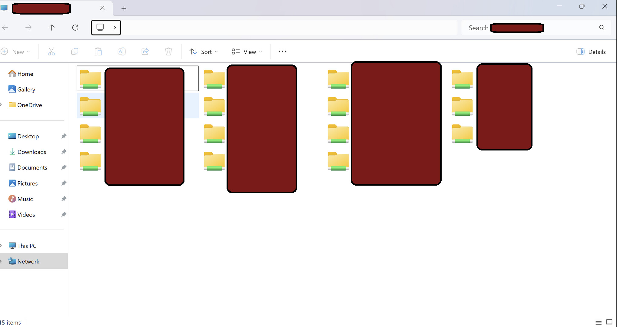

It requested the login/password. I keyed in the NAS admin login info, then the connection was successful. I was able to access that particular shared folder.
Now as a magic, just typing the server in the run command (\xxx.xxx.x.xx) brings up all the shared folders from the QNAP as well.

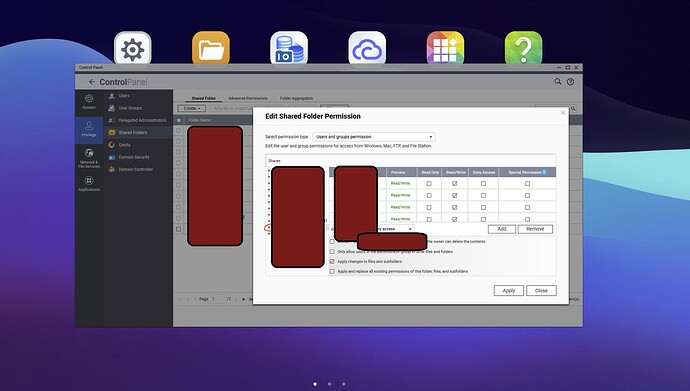

One other thing to try: Control panel; shared folders. Select the folder in question and edit permissions. Make sure the windows user has permission to read and write the folder. I realize this might be trivial-but when I first got a NAS over 10 years ago, I did not realize this. It took me s day to figure out.
Iam not using windows login. I am using admin login.

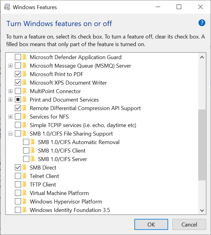

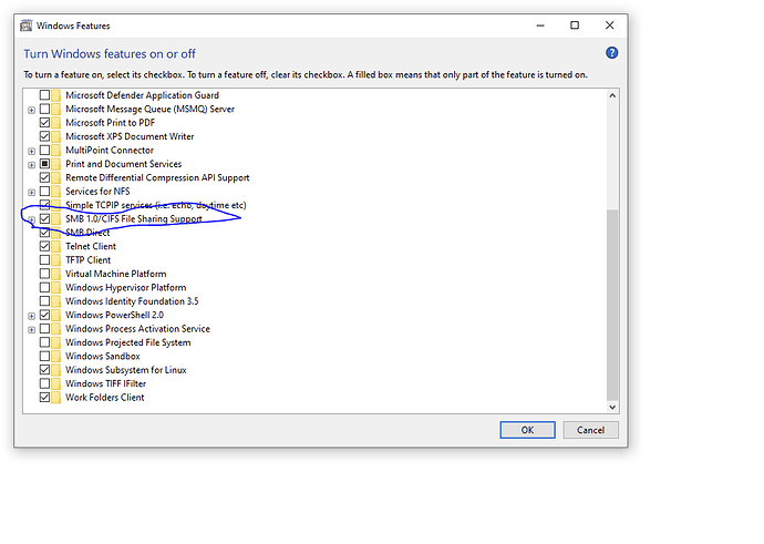

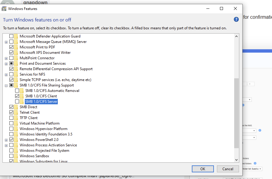

I did so many stuff over the past few hours… I am not 100 % sure what did the trick. But I believe enabling SMB 1.0 on “windows features on or off” did the trick.

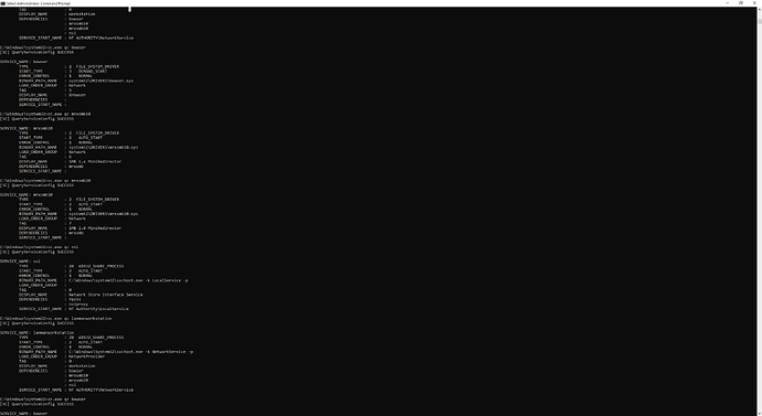

Also executed the below from command prompt (as admin) one by one (Don’t ask me why I did these, because I was googling heavily and found so many things and this is a set of things I was told to query / execute for a error code I saw. Again I cant remember the error code now.
sc.exe qc lanmanworkstation
sc.exe qc bowser
sc.exe qc mrxsmb10
sc.exe qc mrxsmb20
sc.exe qc nsi
Except mrxsmb10, rest all came positive.
So then I enabled SMB 1.0 from Windows features. Did a restart. Executed the above set of things from command prompt again and now everything came positive.

SMB 1.0 was supposed to be vulnerable and enabling that on windows 10 works and resolves the issue even though the minimum SMB version was set as 2.0 on QNAP.
Other update : QuFirewall was disabled and I was unable to swith on that on QTS. So I uninstalled it and then reinstalled it.
QuFirewall was enabled when I made this work on on both the PC’s (Windows10 and Windows11).
Windows11 PC only had one option enabled - SMB1.0/CIFS Client -
So I have updated the same now Windows 10 system as well. But will check the results later to see if this still works.
