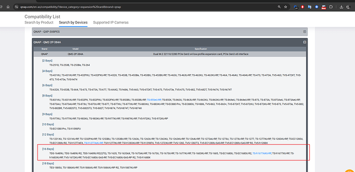

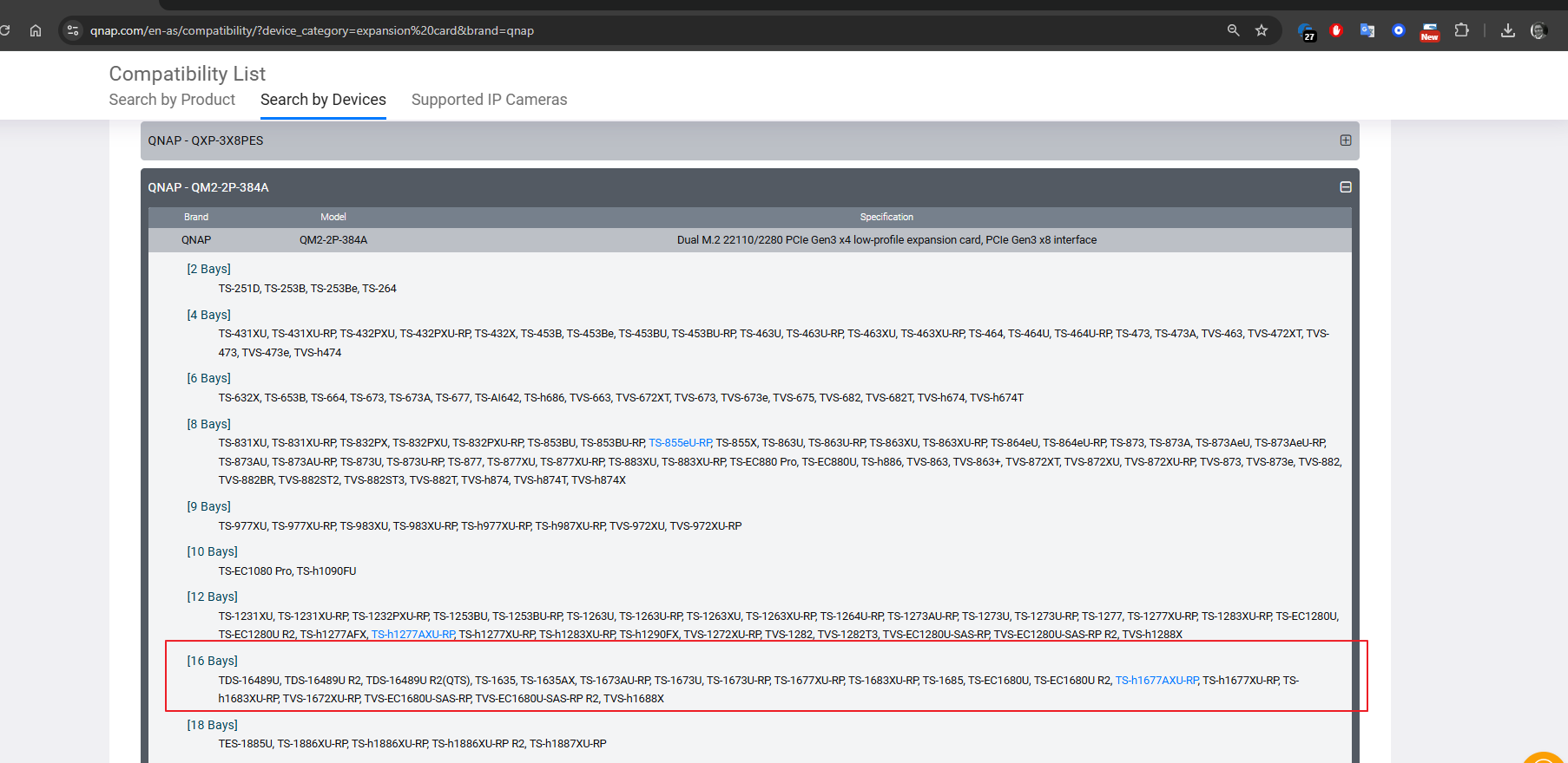

QM2-2P-384A + PCIe Gen4x4 M.2 SSD - Samsung 980 PRO 1TB - Result: did not recognize
The reason is that the support for QM2-2P-384A is not added in QTS 4.3.6. This QTS version is also EOL so there are no further updates to it on this NAS model…

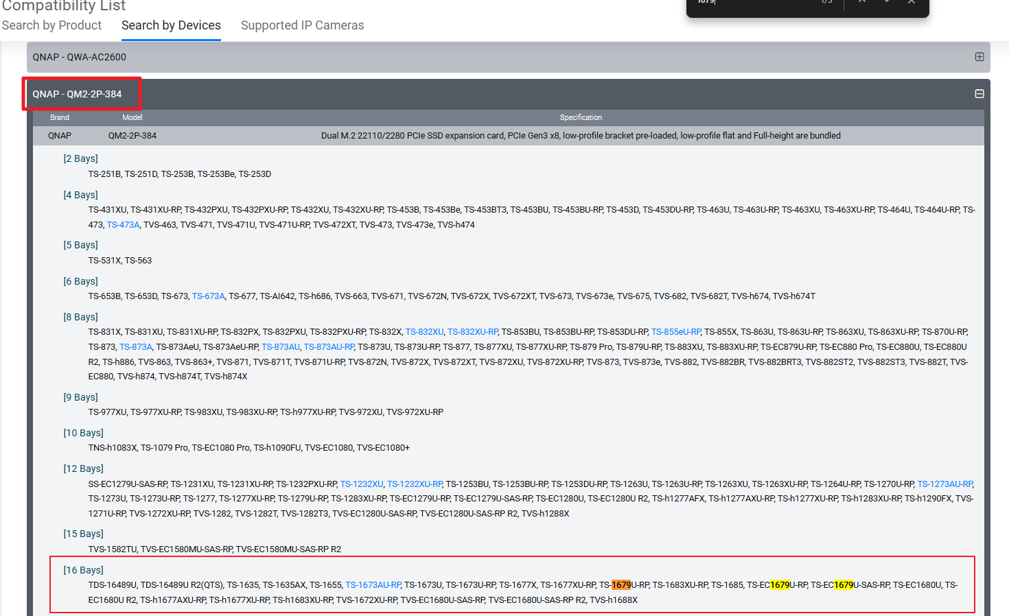

Also, I would like to bring your attention to the fact that TS-1679U-RP don’t support QM2-2P-384A. Please refer to following screenshot and the URL : Compatibility List - QNAP

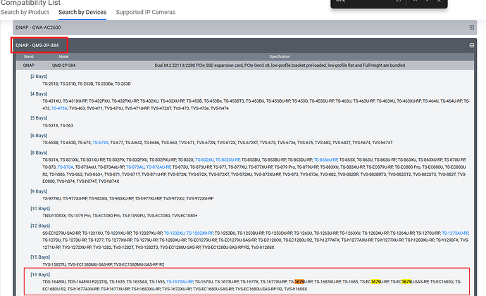

Instead you may try QM2-2P-384 ( older version) which is supported. Please refer following screenshot and URL.
This is to confirm that we have tested QM2-2P-384 card and it worked fine:
Test Setup:
TS-1679U-RP + QM2-2P-384 + Samsung 990 EVO
Result : QM2 Card and SSD both detected and Worked fine, Pass
