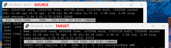

What is the CPU usage during to process, these units are notoriously underpowered. What is the disk model used ?
the cpu is mostly idle; it has a spike when i login to check the status but after a few seconds gets back to 10%-20% on the source device and below 10% on the target nas.

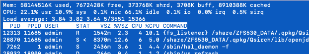

CPU usage means nothing. What you need to look at is the CPU load number in TOP. To access this, log into your NAS using an SSH connection. Then run the “top” command. You will see something like this:
The “Load average” value is what you want to look at. It is roughly the number of threads that your CPU is processing over the last 1, 5 and 15 minutes. You have a 4 core CPU in your NAS. That means if your usage his higher than 4 (say it is 8 or 10), you have a bottleneck and things will start to slow down. These processes can take minimal CPU resources but they are still running and will still slow things down. Each CPU core can only handle one thing at a time. If there are a lot of extra processes waiting in queue, then things slow down.
Running the initial snapshot is likely taking quite a bit of resources especially if you have other things running on the NAS.

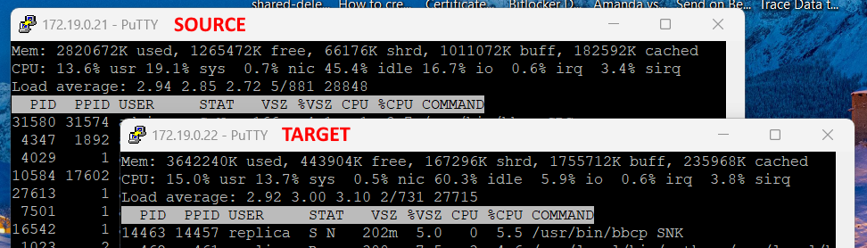

i did not check before upgrading the os, unfortunately; i have already updated the devices with a new version from qnap website (inside qts no update was available) and so far the load is below 4
there are spikes that i linked to a connection to the web interface: if i fire up qts then i see the load rise but that’s expected imho.
if anything was off, it has been solved by the latest os release; now i have the sync running steadily, no more speed going from 150MB/s to zero and then stall.

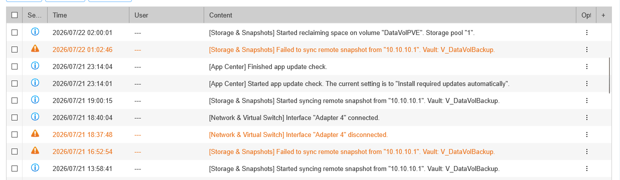

…and I’m back once again because for some reason the snapshot replica works only with a direct cable connection…

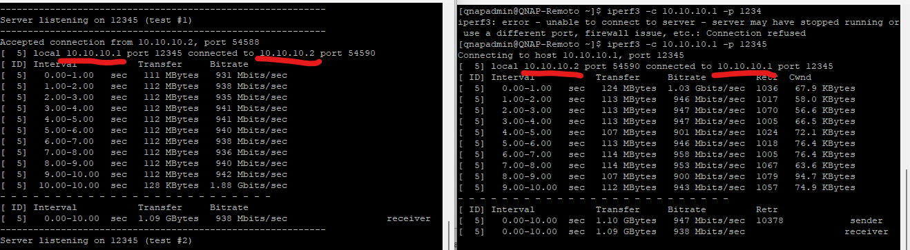

it is not a sudden interruption; since may I spent time trying and opened another case with qnap, but the current situation is that the snapshot replica works when there is a direct link between the 2 units but as soon as i put a switch in the middle (managed switch, 2 ports on same vlan, 2 ip on same subnet, no router in between), the snapshot replica fails.
the goal is to have the replica running over a VPN so I tested that as well, but over VPN the snapshot replica fails.
the thing that puzzles me is that an HBS3 activesync job scheduled hourly on the same link works flawlessly: same devices, same link, same ip addresses, HBS3 works, snapshot replica fails.
one could argue that the HBS3 active sync moves far fewer data: I’m making some more tests with different data size.
