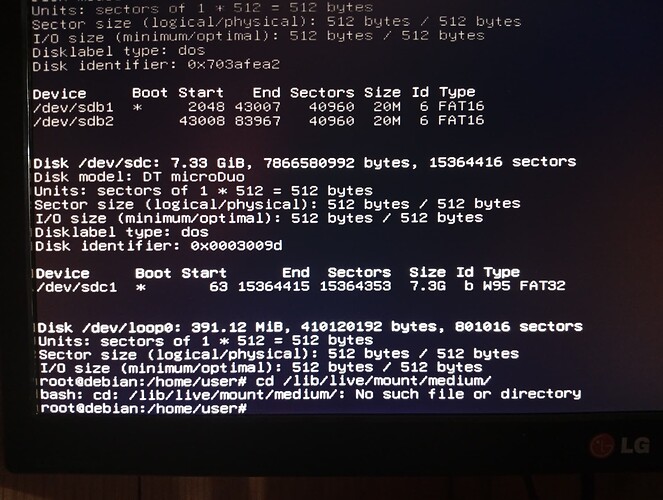

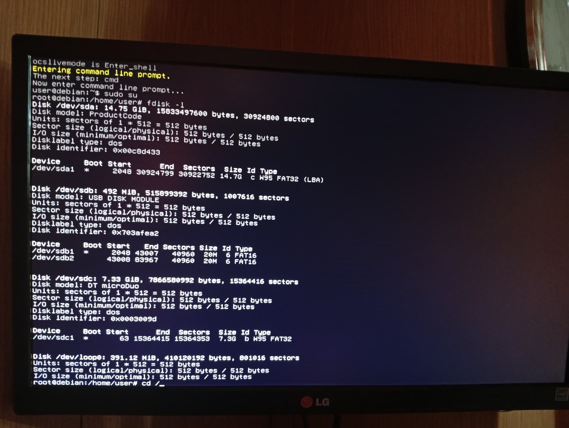

Hello. Please help. I need to reinstall the firmware. I followed the instructions (Restoring firmware in the built-in flash memory (DOM) of a drive
on an Intel processor), but an error occurred.
In the command line, enter the following commands:
sudo su
fdisk –l
/dev/sda - Clonezilla live
/dev/sdb - DOM (NAS)
/dev/sdc - USB root directory - only dom.img (FAT 32, 7 Gb)
Enter the following commands in sequence:
cd /lib/live/mount/medium/
show error
Thank you any help would be highly appreciated!!
Hello,
Here are some information for your reference.
  1. You only need to prepare 1 USB flash drive instead of two. The NAS recovery image file can be copy to the root directory of the Clonezilla USB flash drive you made.
  2. In the command line, you should be able to find the recover image file in the path /live/image/ instead of /lib/live/mount/medium/
Please let me know if you still have any question after trying it.

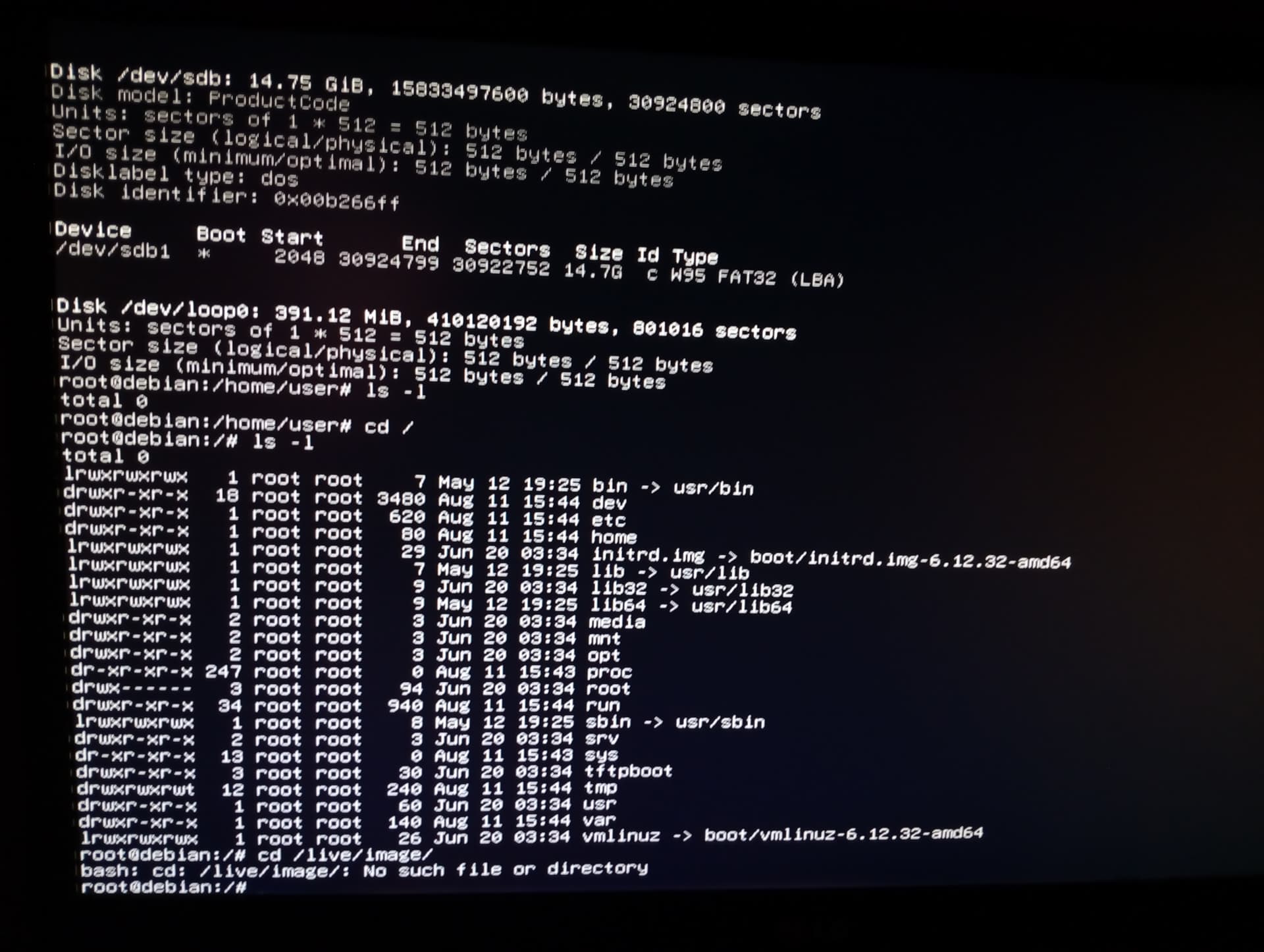

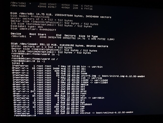

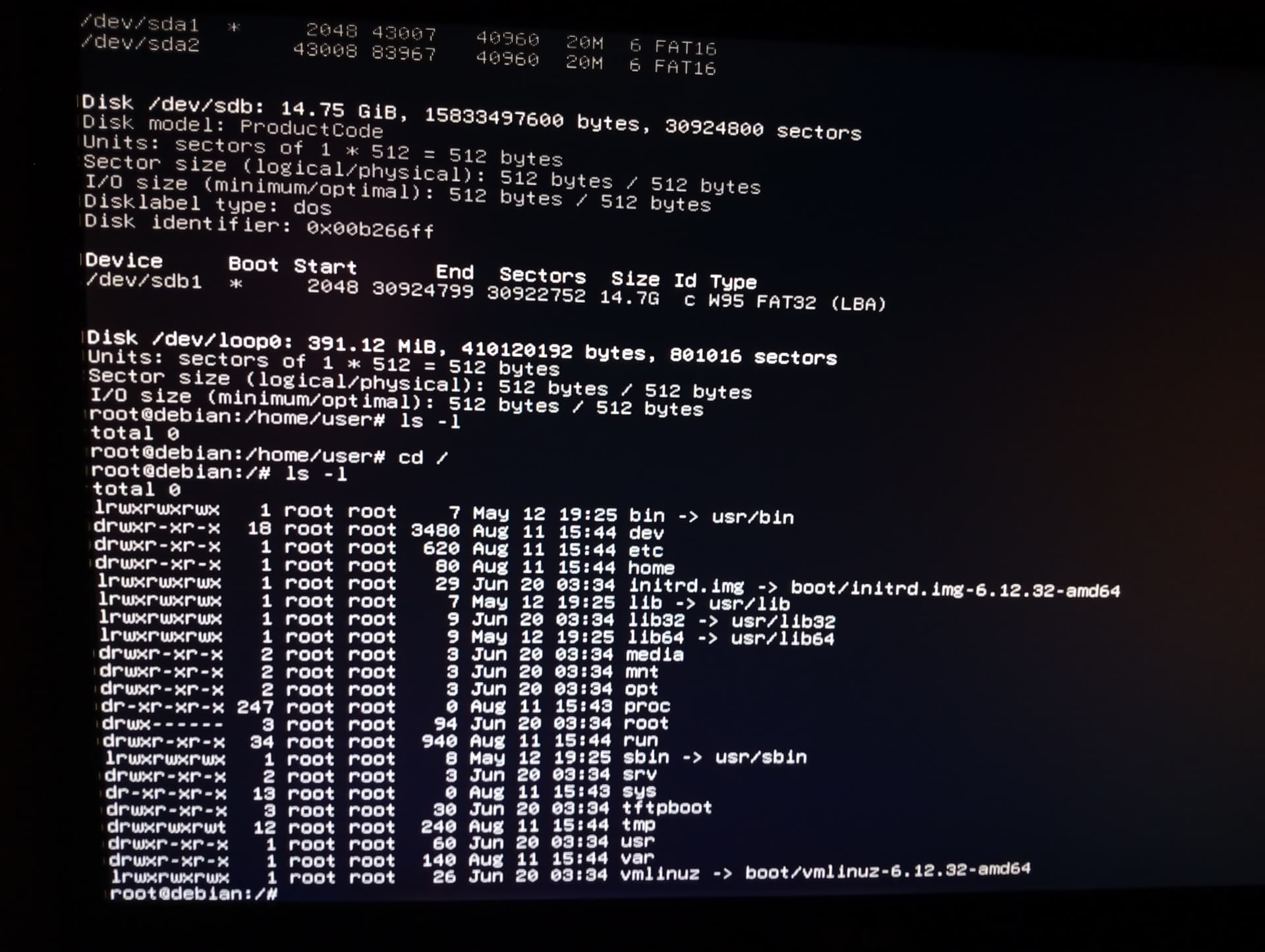

Hi, thanks for the information.
I changed the folder.
After entering the command
sudo su
fdisk -l
and I decided to see where I am and what’s in the folder
entered the command
cd /live/image/
I don’t understand why the device is not available ( /dev/sdb (Clonezilla live)) or why I can’t log in /dev/sdb for copy dom.img ?
Hello,
Thanks for your information.
May I know the Clonezilla version that you download and use and please run the command below and post the command output?
df -h
In addition, you can also refer to the firmware recovery link and do it again.

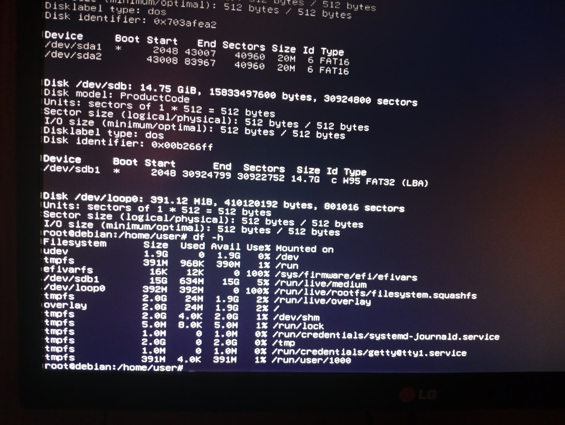

Hi, sorry for the long answer.
I use clonezilla-live-3.2.2-15-amd64.iso
the command output df -h
Hello,
Thanks for you response.
It seems that Clonezilla changed the mountpoint in new version.
From your “df -h” command output, you might be able to find the recovery image under /run/live/medium.
Thank you and have a nice day.
