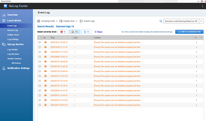

My QNAP keeps ramdomly turning off, no explanation that I can see, I’ll just go to it and it’s turned off. Seems to last anything from a few days to a few weeks. Where’s the best place to look on the system to find out what’s happening? I’m on QTS 5.2.3.3006

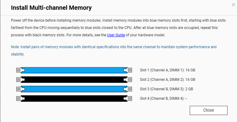

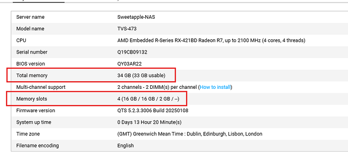

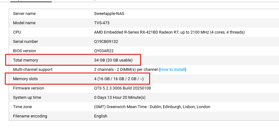

I just checked my order (as it’s been 5 years since I set it up), it shipped with 4GB and at the same time I purchased 2x 16GB Crucial CT16G4SFD8266 dimms, looking at the system information (screenshot attached) I see it lists for the 4 slots ( 16GB / 16GB / 2GB / – ), could that mean one of the 2GB dimms may have given up?
As well as my last comment, I see one of the 16GB dimms is in the wrong slot (picture attached) assuming my best course of action here is to remove both 2GB dimms and move the 2nd 16GB dimm to the now vacant blue slot. If that is the issue, I’m surprised it’s been ok for 5 years and only now starting to have issues… maybe the 2GB dimm failing was the straw that broke the camels back.
I would remove all but the original RAM and test, if it still reboots, open a ticket with QNAP but only keep the stock RAM in it (otherwise support could refuse service)
