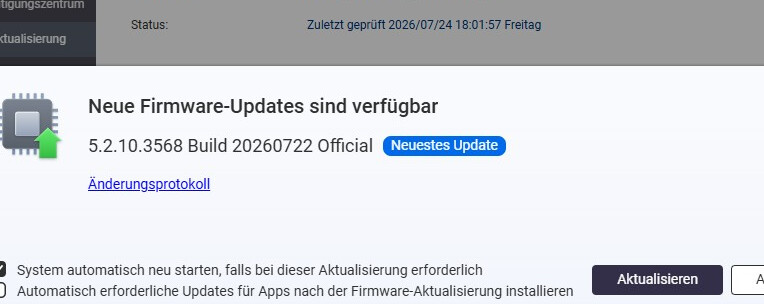

Tried upgrading to this version from QTS 5.2.9.3451, and got a big warning screen from QTS thinking I’m attempting a firmware downgrade.
I didn’t have this issue when upgrading from QTS 5.2.9.3499
I guess QNAP hadn’t yet updated their version check routines to handle ‘10’ as a minor version number in build 3451. :nerd_face:
Update: looks like this problem was fixed in build 3492, as an upgrade from that build doesn’t show a firmware downgrade warning.

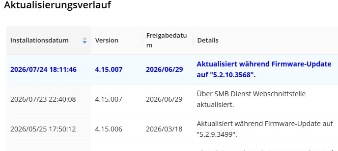

With QTS 5.2.10.3568 QNAP install the SMB-Service 4.15.007.

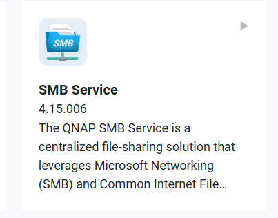

Yesterday QNAP has removed the SMB-Service 4.15.007 from the App-Center. There is now only the SMB-Service 4.15.006 .
There is no info from QNAP.
Hi everyone,
We’ve identified an issue in SMB Service 4.15.007 that may incorrectly determine firmware compatibility on some QTS and QuTS hero systems. In a small number of cases, QuLog may display a message indicating that SMB Service is incompatible with the current firmware version.
To avoid confusion, SMB Service has been rolled back from version 4.15.007 to 4.15.006. If you have already upgraded to SMB Service 4.15.007, you can continue using it normally. This issue does not affect SMB functionality or data access.
Thank you for your understanding and support. We will release a corrected version as soon as possible.

That fits. The issue was fixed in build 3492. :nerd_face:
It is. But it’s the installed build that generates the downgrade warning screen, not the build being installed. :nerd_face:
