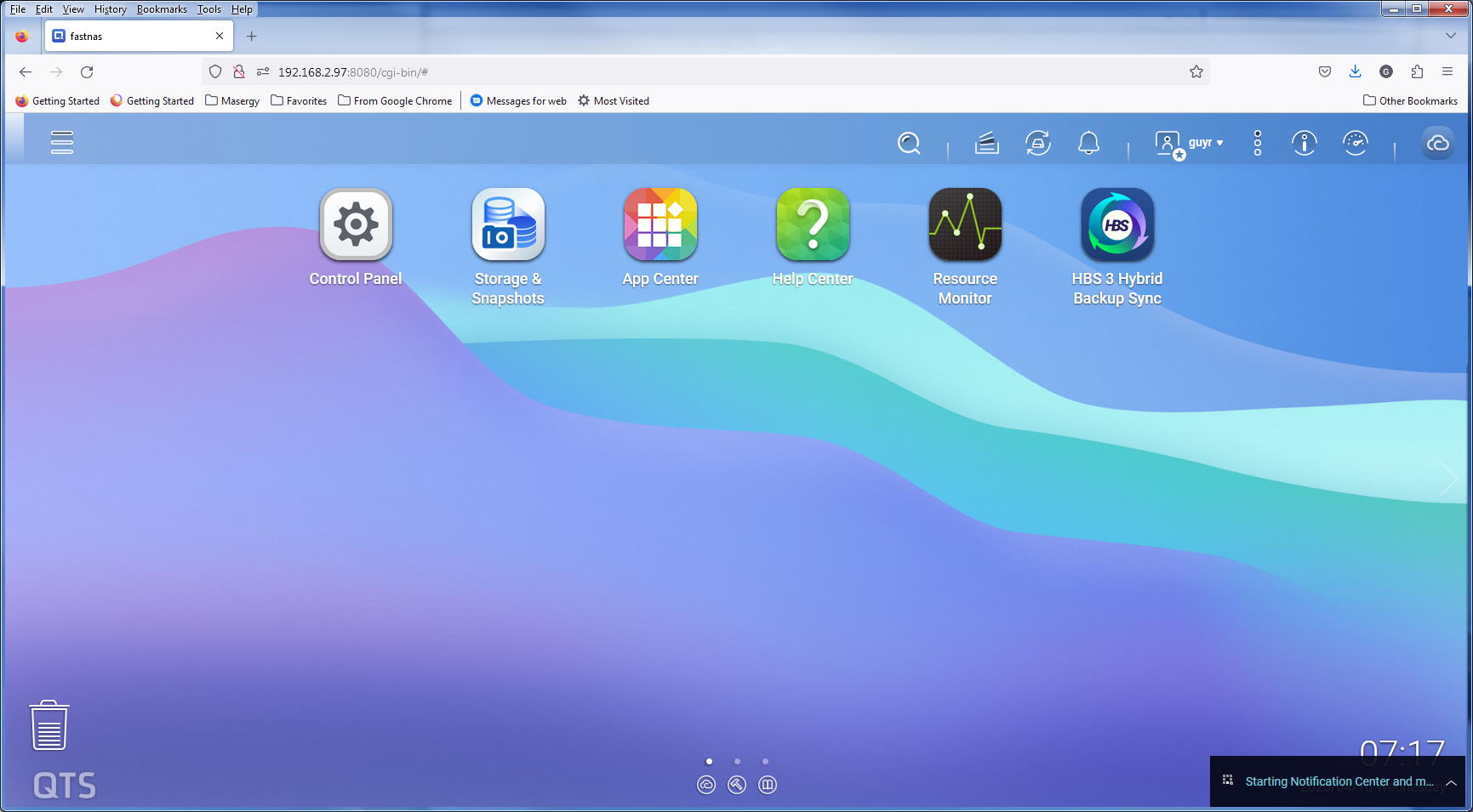

On both my NASs - TS-230 (3079 and then 3092) and TS-253A (3079), when each starts up, they leave a notification message stranded in the bottom right corner. I’ll attach a screenshot of the TS-253A on 3079. This message display is inactive; clicking on either the message itself or the up arrow next to it does nothing. Furthermore, if I close the browser window (or tab) and reopen it, the message is gone.
I think this is a common bug. Several of my 7 NAS’s exhibit this behavior when starting. It means nothing, just hit CTRL-R in the browser to refresh the page.
