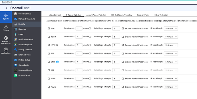

With RTRR, the sync is failing to authenticate, and then the connection gets blocked for 5 minutes each time. I’m sure I’ve got the password correct: I have it saved in a secure (encrypted) password manager. In Control Panel, in the Security tab, I found a setting for RTRR to “Exclude internal IP addresses” from blocking after too many failed login attempts and enabled that on the backup NAS, but it doesn’t seem to make any difference.

So first off, turn off the IP blocking feature for local addresses on the NAS:
