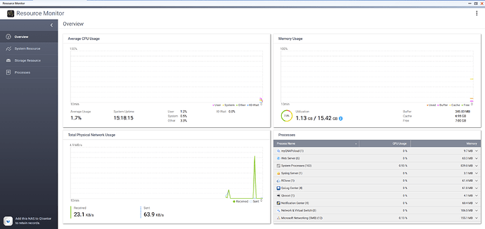

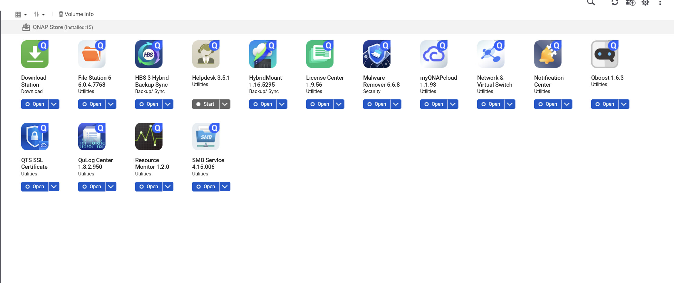

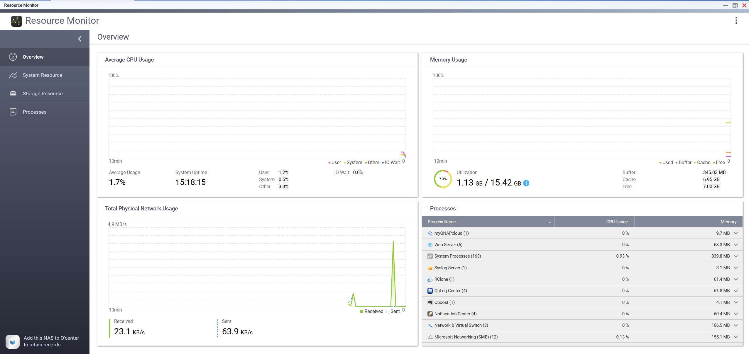

Could you please provide a list of the applications you have installed, along with the apps or use cases you frequently use? We’ll analyze the memory usage of these applications further. Thanks!
These are all my apps, and rclone from QnapRepo, but I don’t use it.
I only use the SMB service to backup data from my computer to NAS. And a backup from NAS to USB External, every morning…
Meanwhile I have installed 5.2.9 and I got no issues till now, I am still testing it for the next days
