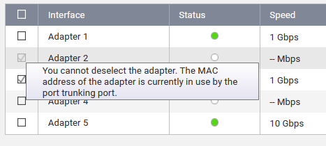

In a test scenario I created an active/backup trunk, but several questions popped up:
  1. is is possible to remove the network adapter, from which the trunk got it’s MAC address - is it possible to change the MAC address of the trunk or must I delete the whole trunk? (If I hover the deselect button, the following message appears: “You can not deselect the adapter. The MAC address of the adpater is currently used by the port trunking port.”)

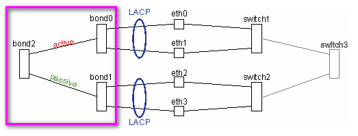

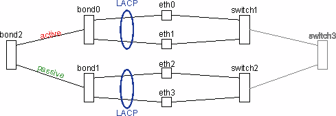

I’d like to trunk two interfaces (eth0 and eth1) for bandwidth aggregation in one LACP channel (bond0) to switch1
and two other interfaces (eth2 and eth3) in a second trunk (bond1) to switch2
(both switches are “standalone” - no stack no MLAG etc.)
Now I’d like to add bond0 and bond1 to an active/passive trunk bond2 for redundancy , so if switch1 gets offline, bond2 sets bond1 as active port
Yes: We want to reduce service outages to a minimum…
Thank you for the detailed explanation and the diagram—it’s very helpful in understanding your intended configuration.
We’ve reviewed this setup with our technical team, and unfortunately, the configuration you’re aiming for—nesting bonded interfaces (i.e., combining bond0 and bond1 into a higher-level bond2)—is not supported. This is due to a limitation in the Linux bonding driver, which does not allow bonding within another bond (nested bonding). As a result, our QNAP system also does not support this configuration.
We understand your goal of achieving high availability and minimizing service outages, and we truly appreciate your effort in designing a resilient network architecture. While nested bonding isn’t possible.
