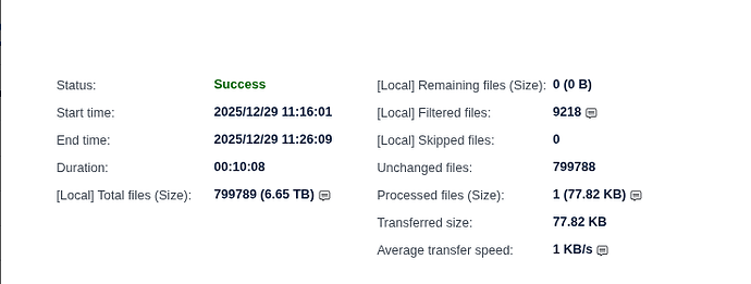

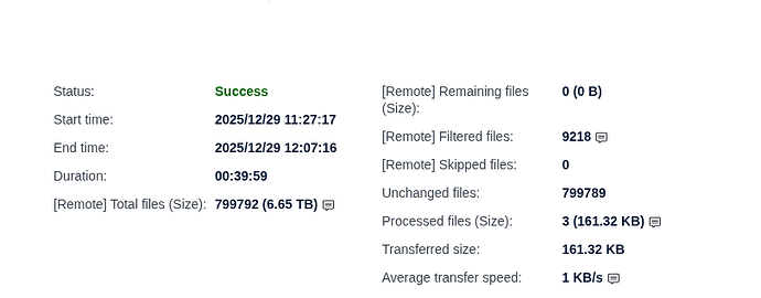

I have NAS1 QTS 5.xxx and NAS2 QuTS Hero 6.xxx
I have HBS sync job NAS1 —> NAS2 PUT it’s finished in 10min
But job NAS2 —> NAS1 same job, same folders but GET, this job finished 39min.
Both NAS connected via 10Gb swith, both NAS has 10Gb Interfaces
There is TEST results.

Same sync job but in one side PUT in other GET, but different results.
