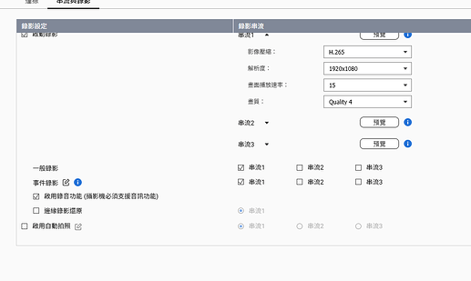

  • The camera has edge recording enabled (recording to SD card) – each manufacturer may have a different method, please refer to your camera’s manual.
  • Currently, QVR Server supports recovery via ONVIF Profile G. You need to select the camera as an ONVIF camera, or use the following versions which have started supporting specific brands’ recovery SDKs:
    QVR 2.6.x: Dahua, Hikvision
    QVR 2.7.x: AXIS
  • For supported models, make sure to check the edge recording recovery option in the stream settings.

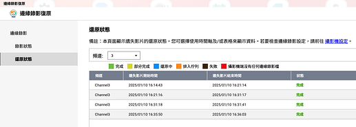

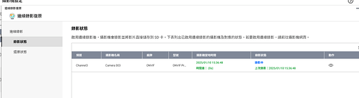

If configured successfully, you will see the protection status in the edge recording recovery feature.
This way, you don’t have to worry about losing footage due to temporary disconnections.
Note: The camera still needs power to record. When testing, if you are using a PoE camera, unplugging the network cable may cut off the camera’s power, making edge recording impossible. You can test by unplugging the NAS network cable, or by pausing the QVR service in the NAS via AppCenter.
