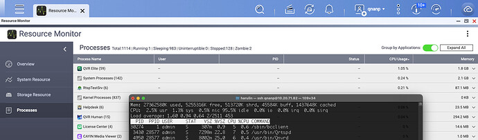

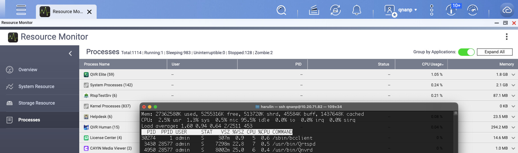

This the screenshot of my QVR Demo NAS, it uses QuTS hero OS and QVR Elite as the surveillance system, manage 16 cameras at the same time, but its load average seems fine…
Hmm. That is interesting. It definitely made a difference in my system load and I just have two cameras. What is the CPU in your demo NAS?

The previous screenshots is using TVS-h874 with QVR Elite, so I try again with another NAS.

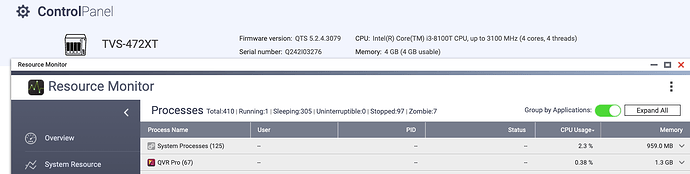

This is TVS-472XT with QTS, and QVR Pro with 2 channel recording. But the usage rate seems to be normal.
