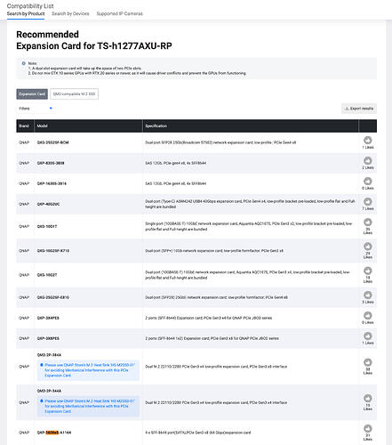

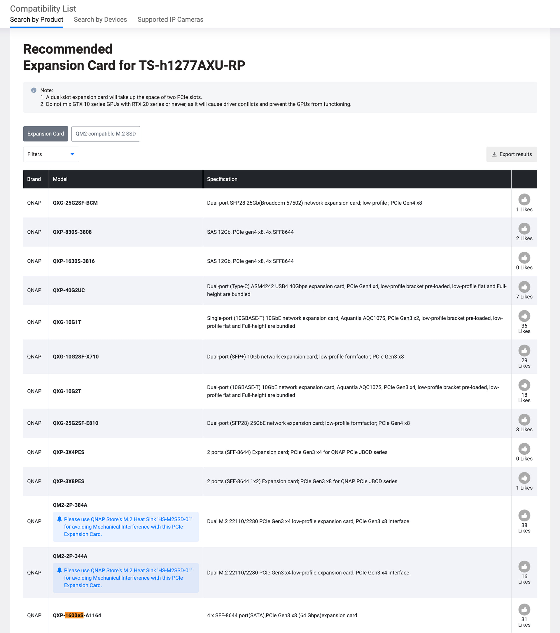

The QXP-1600eS is on the compatibility list of TS-h1277AXU so it should work.
You may have confused the two models, QXP-1600eS-A1164 and QXP-1600eS. According to the compatibility list, the QXP-1600eS does not support the TS-1277AXU.
Hi kidzsato,
The QXP-1600es PCIe card reached EOL (End-of-Life) a few years ago, so it was no longer tested on newer NAS models. However, we will arrange for compatibility testing in the coming weeks. Please check the compatibility list on our website again later."

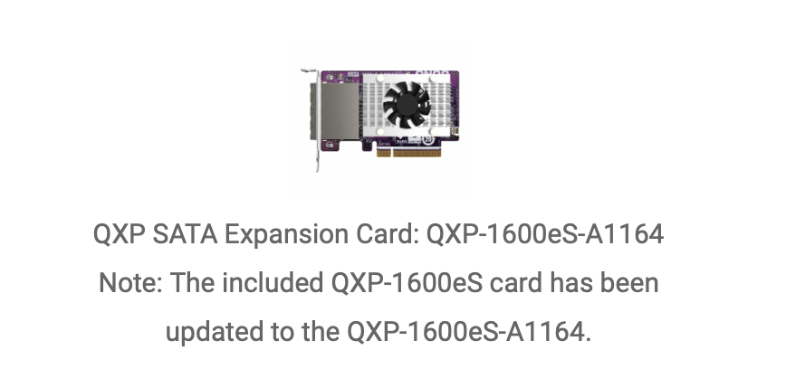

Hi JasonH,
Thank you for your support. It seems that Qnap has just updated the network expansion card for the TL-R1200S-RP, replacing it with a new expansion card, the QXP-1600eS-A1164.
Hi kidzsato,
If you buy a new TL-R1200S-RP now, then it already includes the newer QXP-1600eS-A1164 PCIe card.
