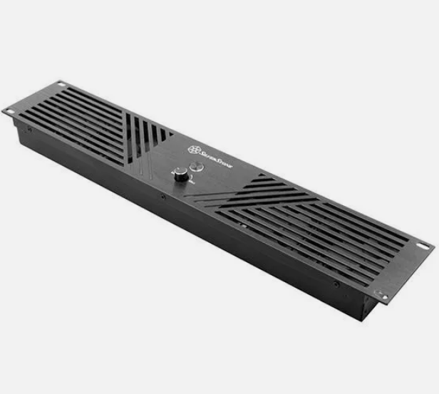

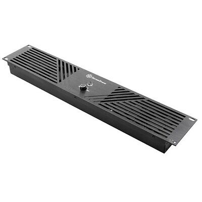

There are a couple of other options if you are a bit more “ambitious” but they are more difficult with the easiest one being that you can reserve two more rackmount heights for cooling your NAS. You can do this for example by adding a multi 80mm fan segment in the front above the NAS and open the lid:
And you could add another one in the back for good measure with one array pushing and the other pulling.
You will have to seal the area between the drives and the built in fans though to maintain a funnel effect when you take off the lid, I did this with some simple paper based masking tape that leaves no residue.
ACInfinity do some nice fans for racks.
