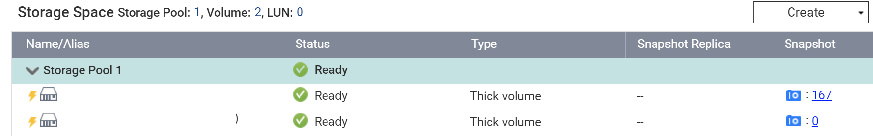

I am using Storage pool with thick volume. Does it mean, that I should resize each volume (for each drive) and after that expand pool ?
There is no volumes on each drive, the drives are in a RAID.
It means if you increase the pool size, it will not automatically change your volume size.

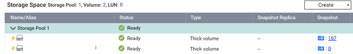

I am a bit confused here. According to this screenshot in storage pool I have volumes. I created them on the purpose, as I need different approaches related to snapshot creation for them. Maybe you understand something else by this.
That’s why I said that many people get confused.
When you add disks to, or swap disks out of your RAID, you have to look at the pool (the level above the volumes) , marked in your case with “Storage Pool 1”, here you add disks and/or increase the size of the pool
