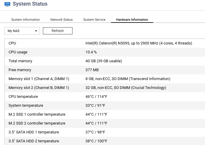

I think you should buy more RAM for your new TS-464.
My TS-264 with QTS 5.2.x work fine with 40 GB RAM.

I bet your unit runs well with 40GB😀! I am just trying to get basic backup functionality and near 10Gbps speeds. If I am just getting more memory to run QuTS Hero not seeing the advantage in my use case.
