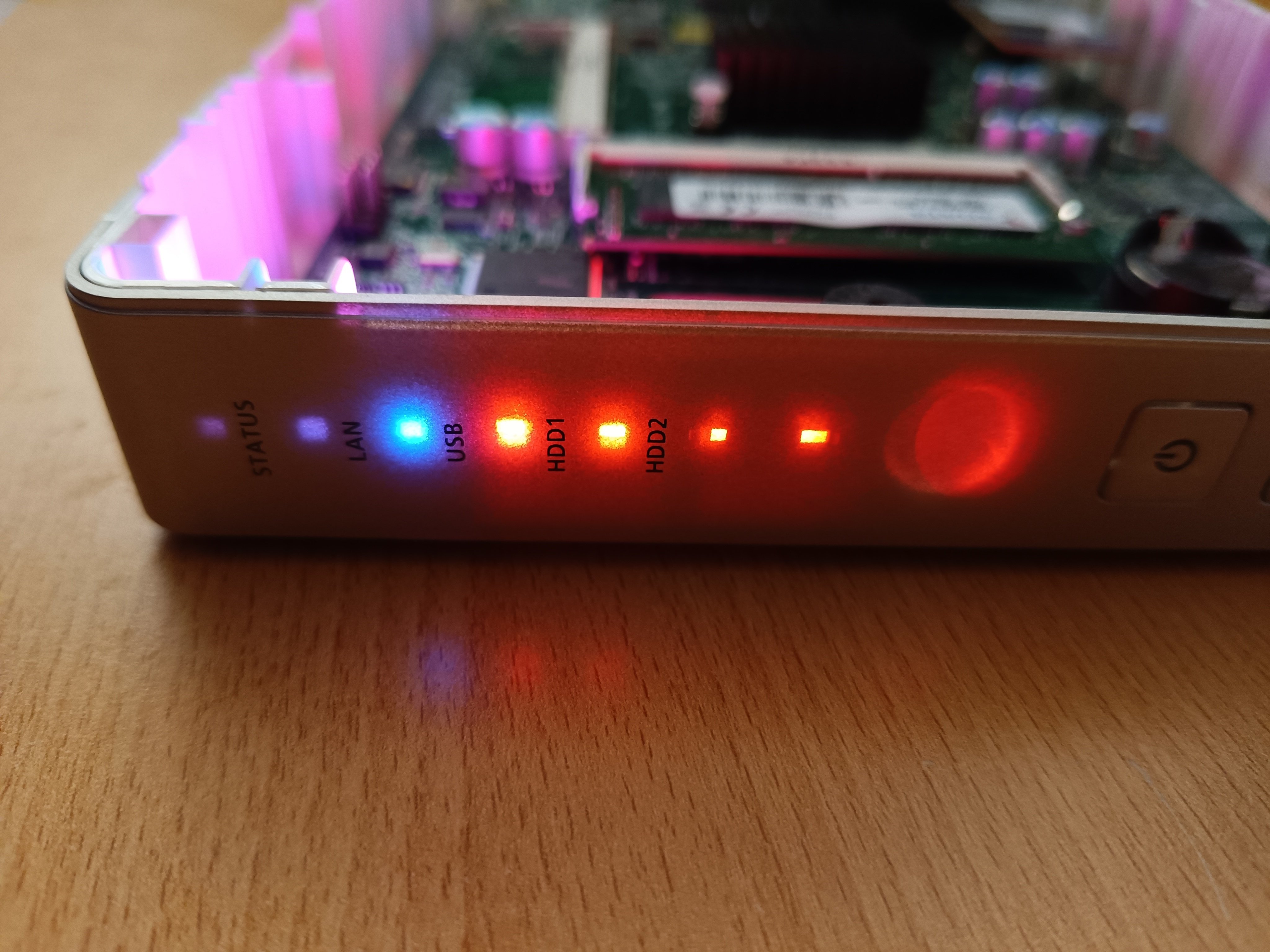

After nearly ten years of trouble-free service, my TS-251+ finally succumbed to the well-known clock degradation problem and greeted me with the full complement of red LEDs.

In the end, I went with option 3 using a 90 Ohm resistor, and the old TS-251+ now has a new lease of life.

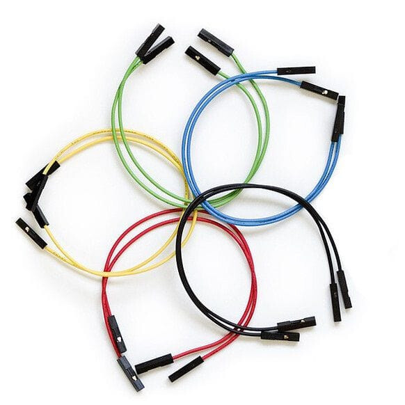

It is an easy fix if you have a small soldering iron, or you could use female=-female jump leads:
