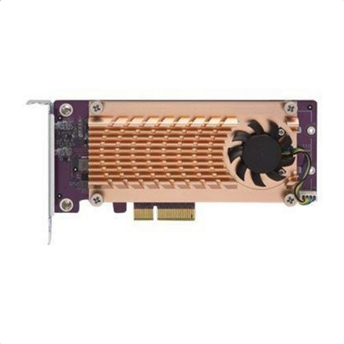

Replacement fan for the Qnap Qm2 dual NVME card.
Fan failed, I need a new one, and I don’t want to RMA the card. Dispite the fan failing, the NVME drives are staying a cool 48c, most likely due to the other fans in the NAS I have.
Anywho, I have figured out it is a 4 wire 26mm 12v fan.
I am thinking this EVERFLOW T127010BU might be a good fit.
Any recommendations on a replacement fan?

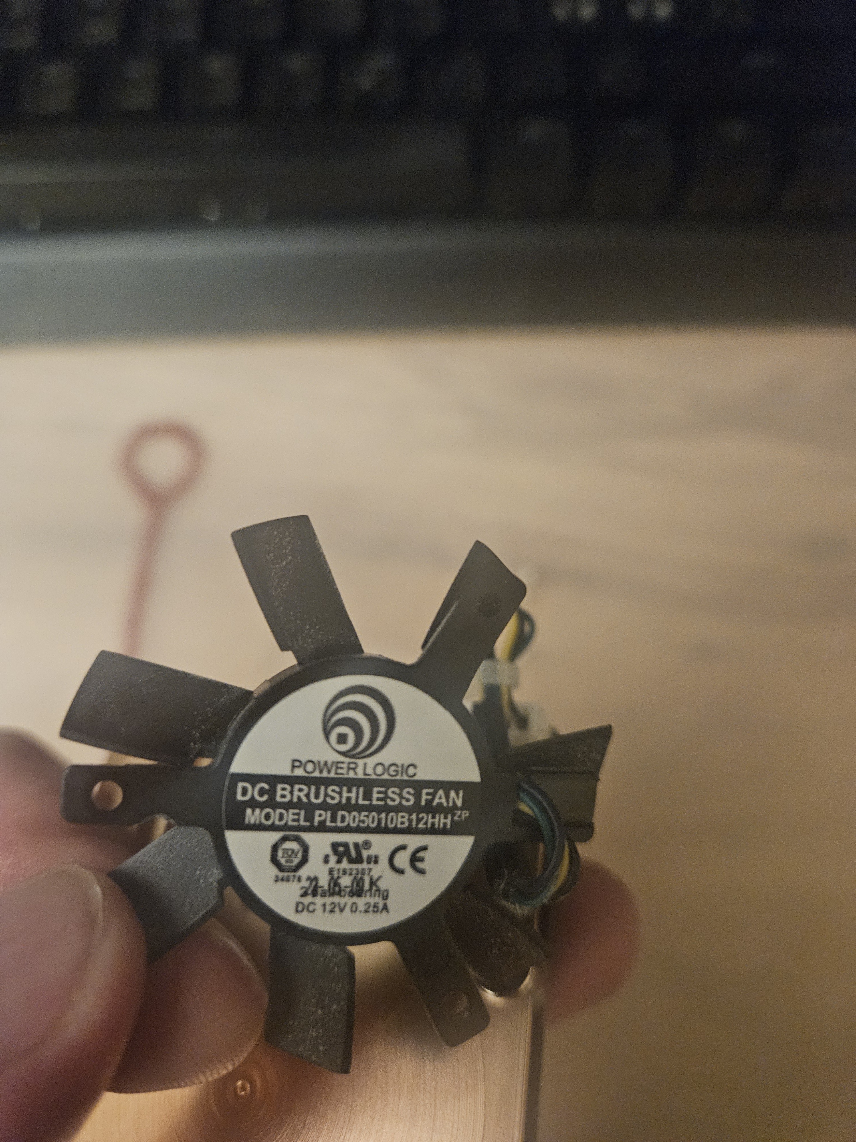

This is the exact fan fitted to the card: Power Logic PLD05010B12HH DC 12V 0.25A Ball Bearing Axial Cooling Fan - FanDevice.com
Of course, rare as hen’s teeth.
yeah that seems to be the right one based on pic. guess they dont use the same size fans on the nvme cards as they do on the nics.

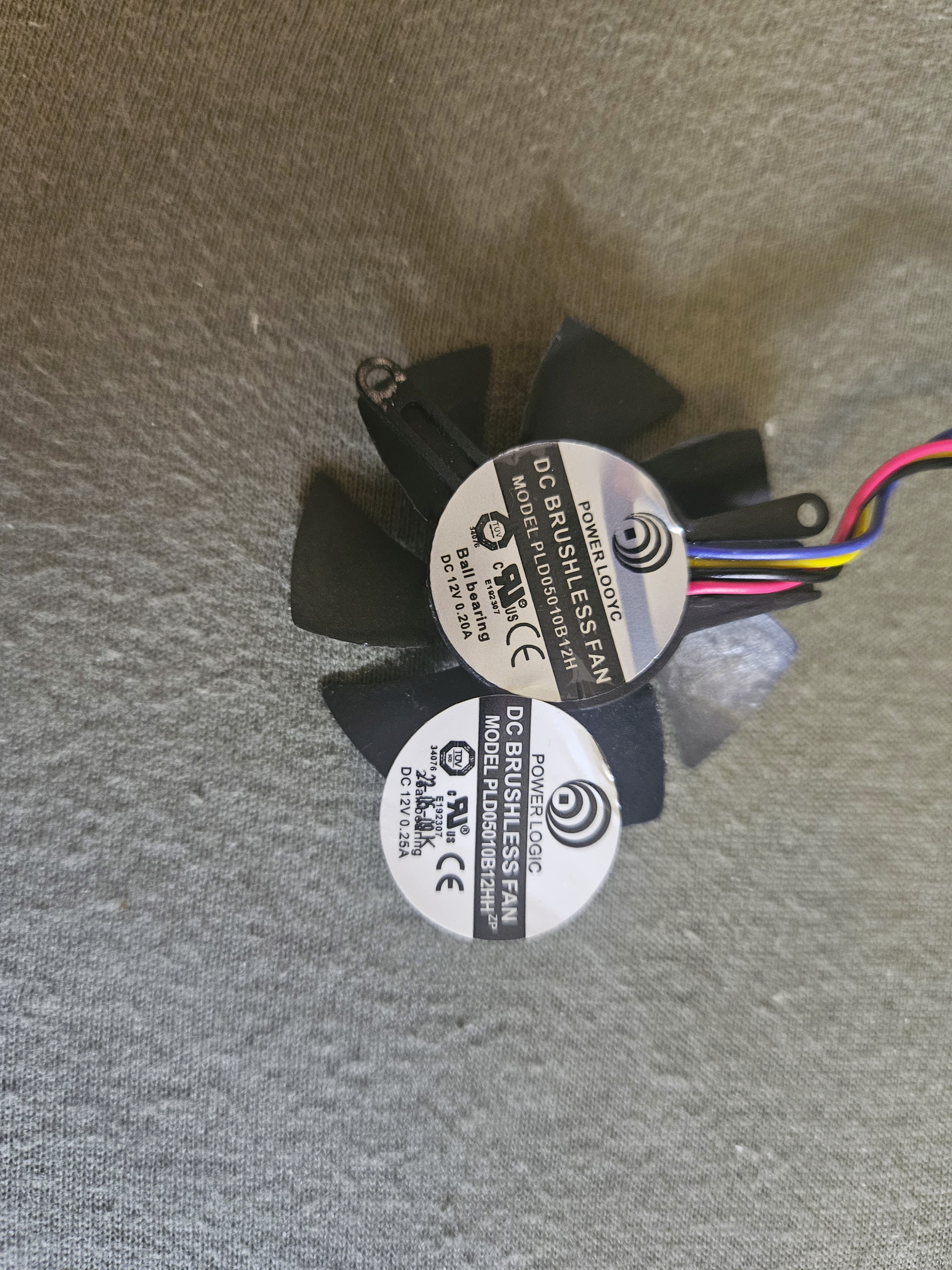

Well, that was a bust.. I was sent a fake/counterfeit fan.. It was “all wrong“ Name to start off, was Power Looyc and not Power Logic… lol the rest was just tragic.. I just stuck a nvidia gpu fan in there to stop the fan failure messages…
The legs where too thick, inferior design and quality… Not to mention the wrong size….
