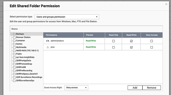

You set up access to shared folders in the control panel and select to edit shared folder properties. Click the permissions button for the folder you want and you see a window like below. You can choose what groups or users get access to that folder.

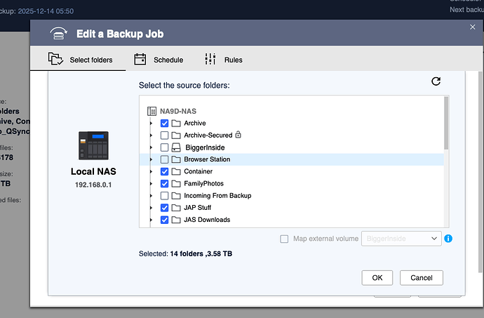

Now, to exclude a folder from a backup set, that’s done in HBS or whatever backup client you are using. You select what folders you want in your backup set.

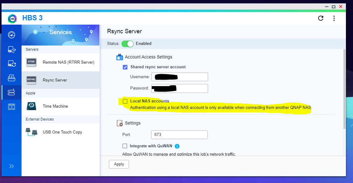

All this is clear, but that is absolutely not what I am talking about. Once again from the beginning. I have 10 shared folders on my QNAP, each for a different purpose (for example, N7 - for all backups ). The rsync-server is deployed on the QNAP. When I connect to rsync-server externally, I see all 10 folders. This is bad. I should only see the one designated for backup (seventh). The screenshot indicates that connecting using a user profile is not possible if the connection is made from a non-QNAP device. I enabled this option, and unfortunately, it’s still true..
How then can I configure the sync profile (the separate one, pictured above) so that it only sees one shared folder? This only needs to be done once, not every time you set up backups on an external device. Viewing all shared folders at once is not secure.
I think it’s not possible.
The rsync server runs internally as root and has access to everything. It also has no privilege mechanism, so if you need to restrict accesss to certain folders you cannot use rsync
As far as I know, the mechanism of rsync operates as dolbyman mentioned. To manage permissions, you would need to use NAS user accounts.
However, I will report this requirement internally and let the development team evaluate if there is any possible way to achieve what you are looking for.

Have you used rsync option on the hbs3 QNAP server yourself ? If so, you know that when you connect to server, only shared folders are visible. But all shared folders! It’s bad!!!
If QNAP device has three different servers - file storage, music storage, and a third-party backup storage. Why would someone using the backup server see the folders where the photos and music are stored? These are three DIFFERENT servers on device; they shouldn’t overlap!
